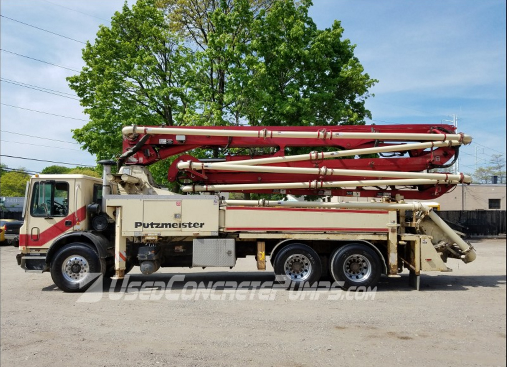

My 38M Concord has hydralic line to the material cylinders that drip oil onto material rods each time the pump strokes. My 32 Schwing doesn't have this set up. My question, is it something I need? after a days worth of pumping there is quite a bit of oil mixed in my water box that I dump on the ground. |
| bisley57 | 11-17-2015 | reply profile send pm notify |
Yes,this putz and the knock off putz pumps have an oiler hole in the material cylinders.You can adjust the flow rate of the material cylinder drip line. |
