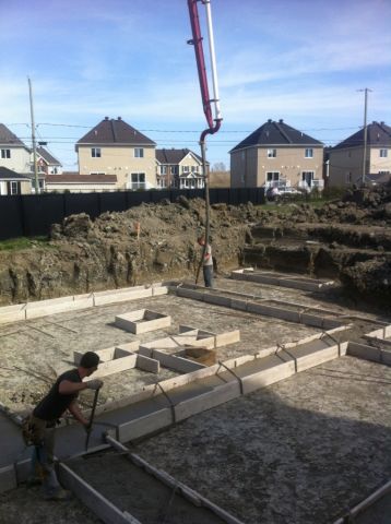

After nearly 2 weeks and spending nearly 13500$ to be D.O.T. approved.I finally could start prep my 41m and today i pumped my first footing with it.this morning i open all elbows.grease a the boom,did some plumbing works.I went pumping a small footing(10m). |

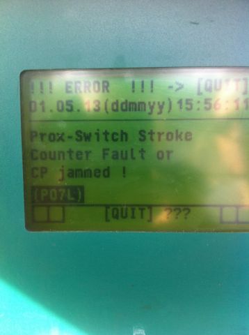

and then i understood why the horn was disconnected |
| Ti-so | 05-01-2013 | reply profile send pm notify |
the other message is i need to replace my hydrolic filter but any tip on this one???
Next week i ll post picture of my 41m all clean up and all 8 wheels buffed!!!! |
| gboom | 05-02-2013 | reply profile send pm notify |
Tiso,
the prox switch is the one that is mounted at the shift cylinder for the rock valve, before replacing the switch, clean it up real good, it may start working again. the fault code for the hyd. filter should specifiy if it is the filter for the concrete pump or the boom, anyway if you dont know when these filters were changed last, replace them both.
if you have a fault code for the cp hyd. filter, unscrew the switch, you may have a short inside the switch, tht is a common problem (this switch is located at behind the oil cooler) |

| Ti-so | 05-02-2013 | reply profile send pm notify |
yeah i reconnected it,i ll solve the problem tomorrow .I order my new filters and i ll look at the prox switch and clean it.Thank you GBOOM and you to Mudslinger
