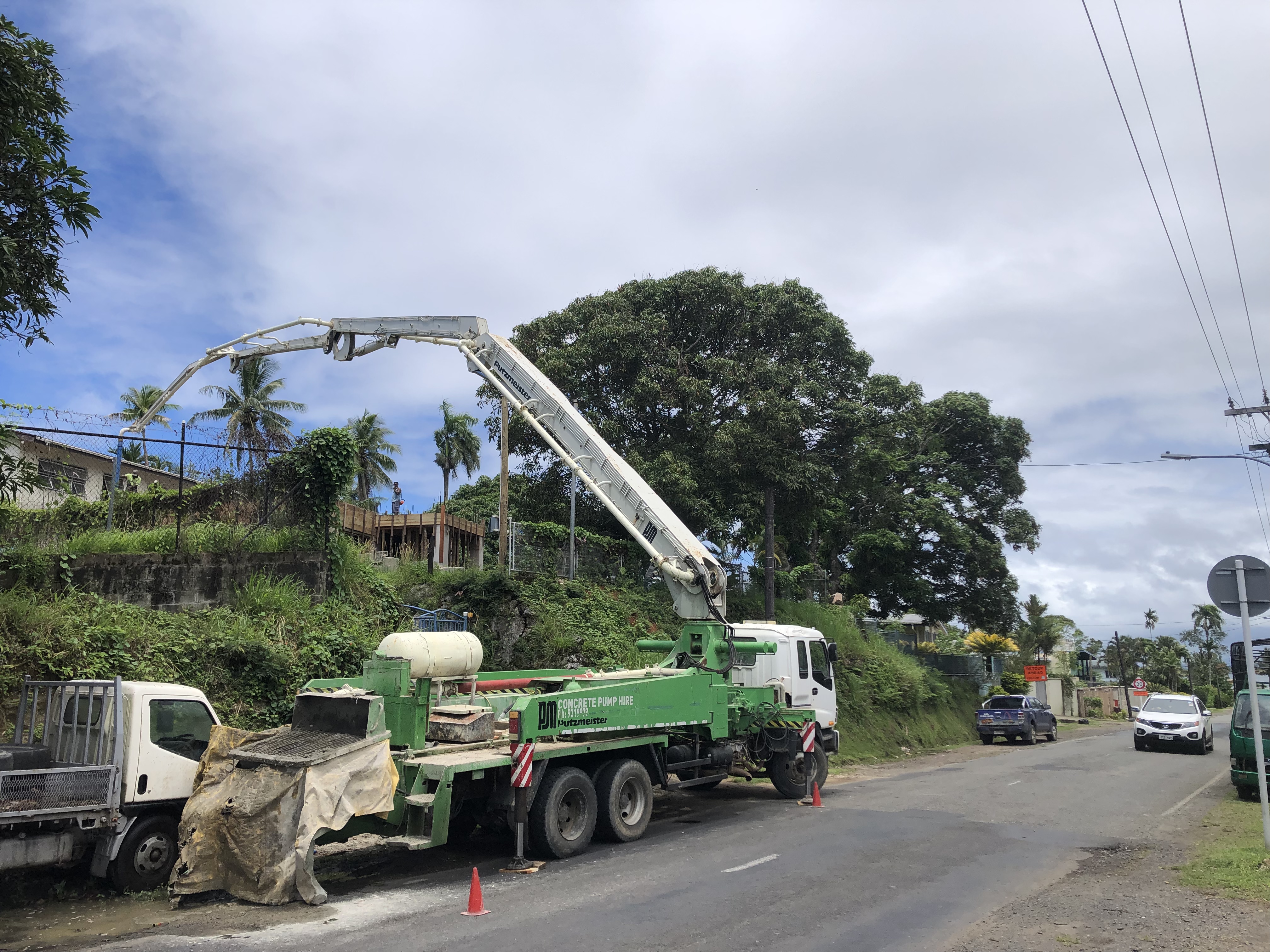

A025007 6Ltr Accumulator for for putzimeister concrete pump , how much nitrogen gas should I refill, can anyone tell of you know please I think my s tube is slow due to that.

Hello, All can anyone tell me how much should I refill the nitrogen gas in my accumulator, I think my stube is slow due to the accumulator, but I don’t know how much gas it requires. Thank You |

Mate First read nitrogen press The pressure must be between 70-80 bar Regards |
