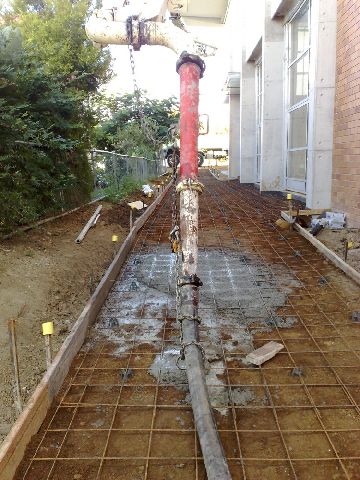

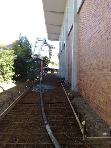

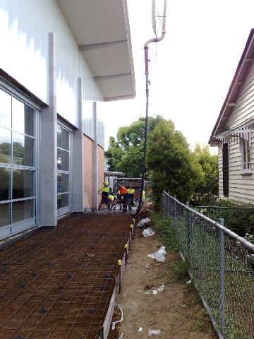

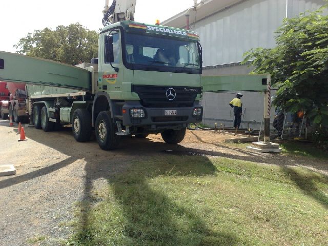

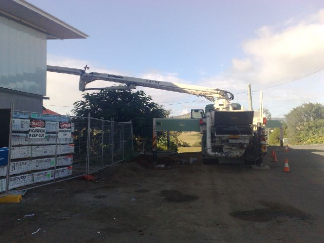

Nice pics, but why are you short riged? Whats keeping you from being able to open your out riggers all the way? I dont see anything keeping you from opening them up all the way. |

Good Point, So I investigated this Myself. The Client would not allow the right rear outrigger to be extended as it is on a Road. The rear would impede on traffic and the front does not. Jon Performed an Operators Concrete pump set up check sheet and performed a risk assesment for the job. Diagrams Drawn showing how the pump was to be set up short rigged and the Control measures. The Contractor is then asked to sign the Short rigged Risk assesment signing that they accept responsibility for short rigging on their site as they have not fullfilled their obligation and provided clear and adequate area to set up the pump. This pour was from March 2010 and I have jons risk assesment in front of me. Well done Jon. First class operator with great Paper trail to match. |

OK, sounds like your on top of it and thats good, its kinda hard to make out whats on that side of the pump and thats why I asked. Great looking pump, what size is it? looks like a 41m or so? |

The biggest risk for a US pumper is heart attack due to major high stress level. I stand short rigged almost every day. Whats the big deal? (when you know what your doing) Just don't forget where you can or can't schwing your boom. Just like you don't forget to brake in your car when you have to stop... |
