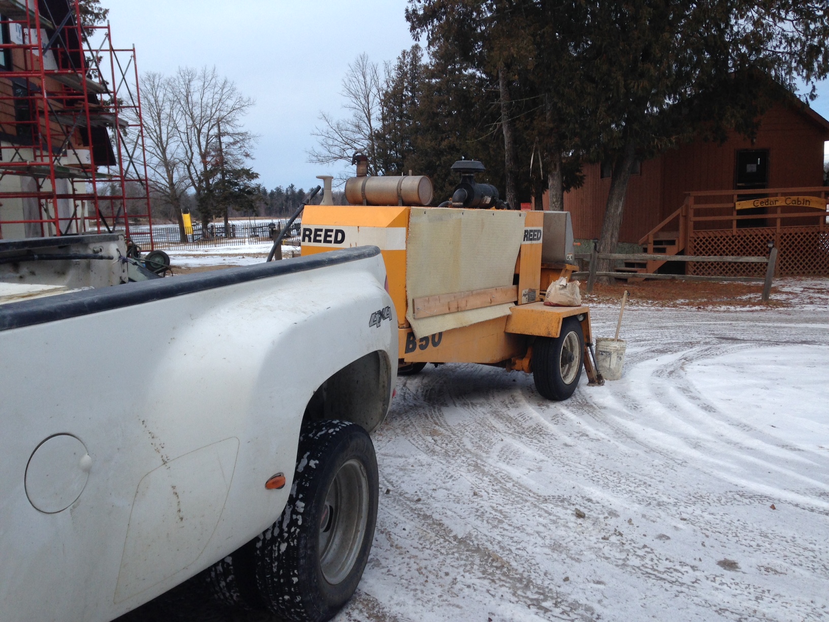

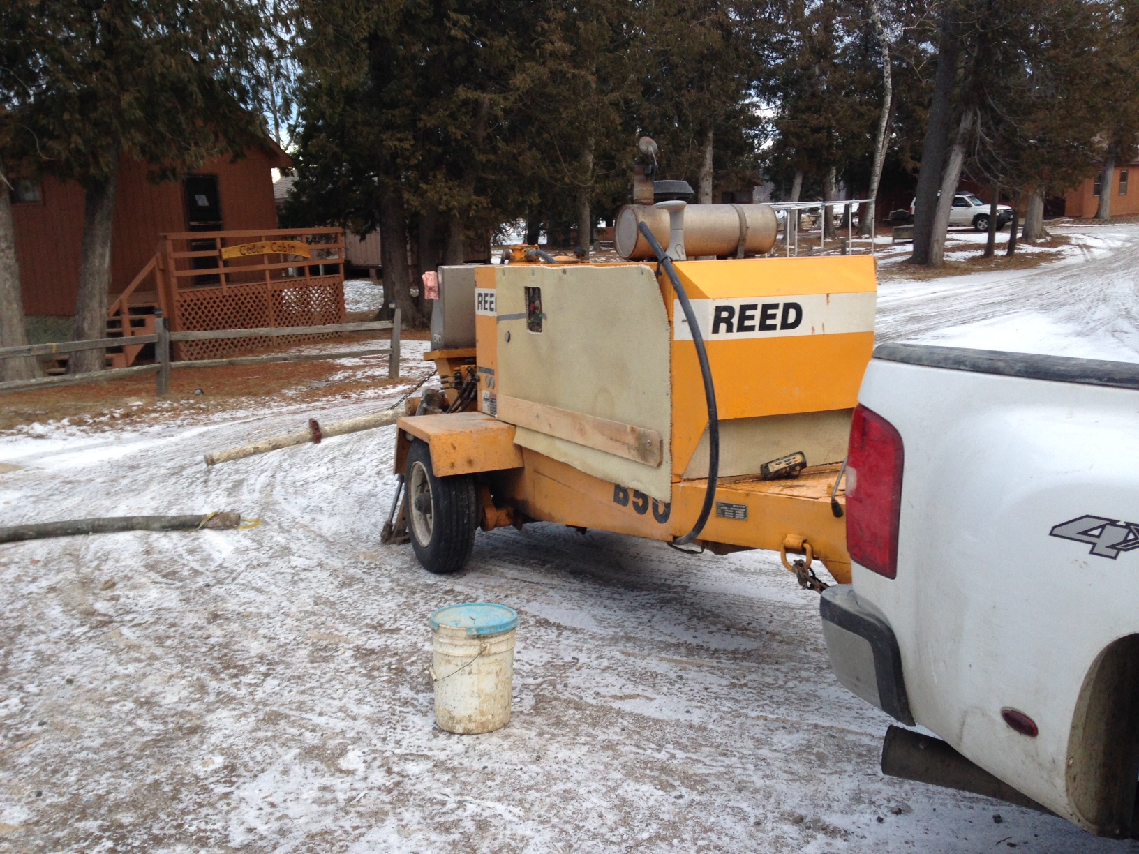

Proto type i made because i had to travel 130 miles and pump when it was -14 F. Yes it is carpet. I keep the pump running for the ride and it stays nice and warm. Actually it makes the pump much quieter when pumping. |

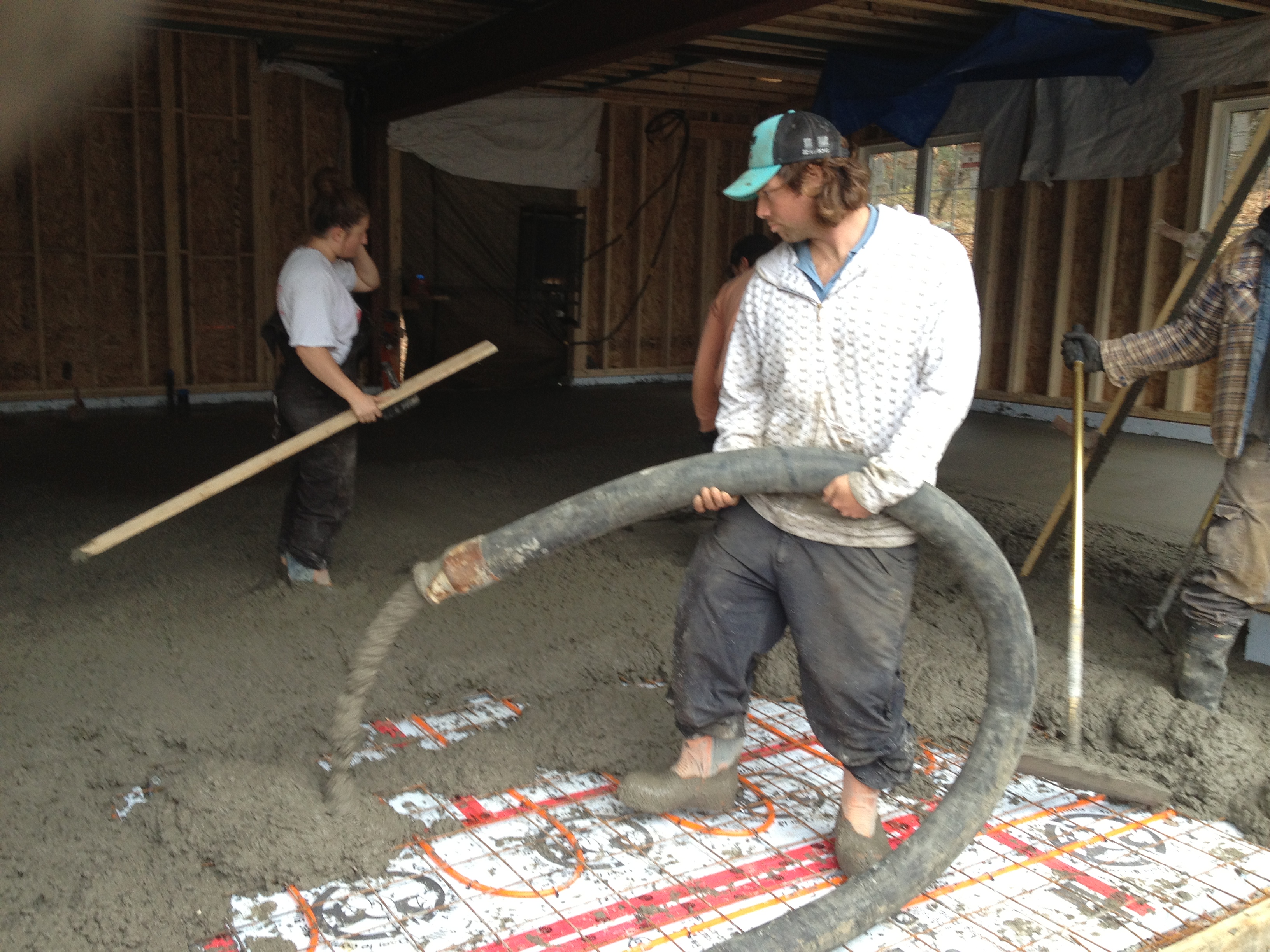

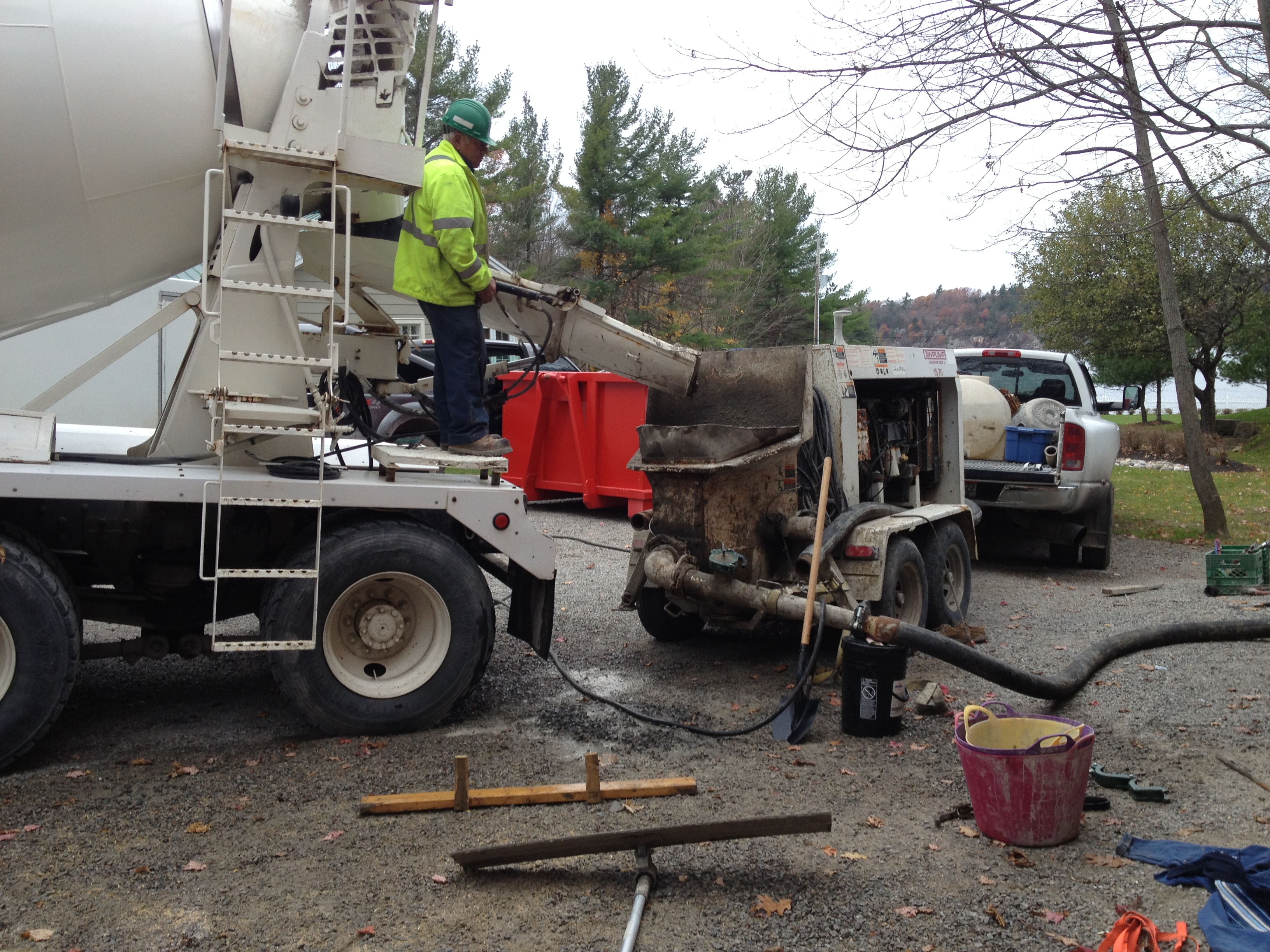

Hey Brian , I haven't been out in the cold temps with our Olin this winter. My current pull truck is a 3500 Dodge dually 4x4. In summer I load 100 gals of water in a plastic tank, a 5 hp gas compressor and a double diaphram air drive 3/4 inch pump. I don't ever use much more than 40 gals, so the extra get dumped if there isn't a second pour. Lots of days I can suck back the line and use next to no water, so I will probably reduce to 50 gals in future. I have used air to assist the suck back a bit, but I'm no expert like those guys in Oz :-) We pretty much switched to using our 28m and 3 inch line for our basement floors as we have had too much shrinkage (read cracking) with the small rock mixes in 2.5 inch line. |
| ericICF | 01-04-2015 | reply profile send pm notify |
3 inch line garage floor early Nov |

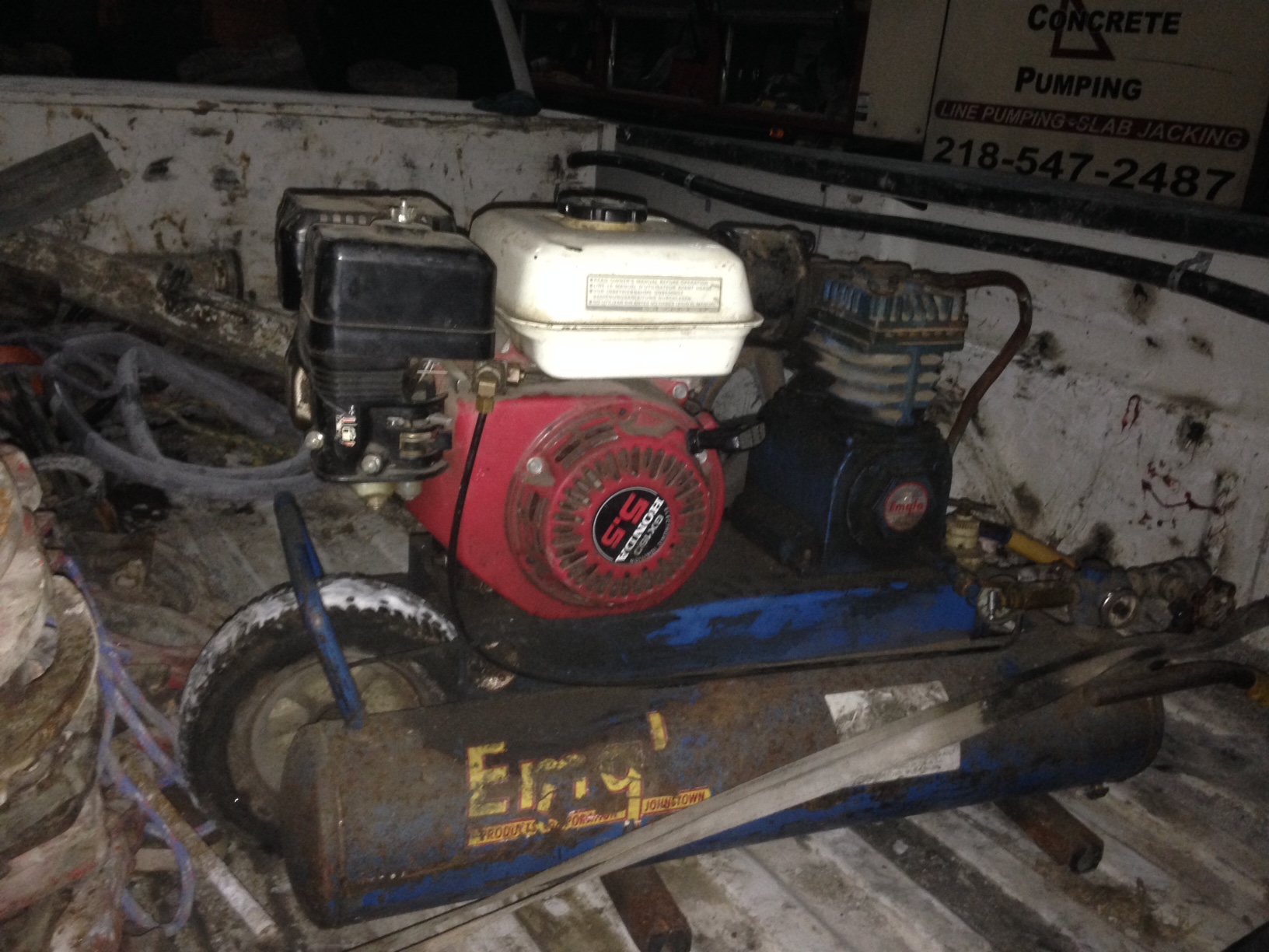

Thanks Beast and finish yes its scary when you do the math.. Also interesting. Actully i was thinking maybe a 50 gallon hot water heater tank but then i did the math and figured it might be bomb potential. So now i am looking for a compressor tank 50 gallon or more. I scored a honda compressor today. Runs great. |
| ericICF | 01-05-2015 | reply profile send pm notify |
Good score Brian. Same as what i use. See if you can get a good used water tank from a Mixer Truck...they are really made for the job , compared to something you have to rig up. And they will have a manufacturers plate on them so you are in compliance.The diaphragm pump is safer option tho. Go for a 1 inch dia on Ebay , mine is a bit slow on volume. |
