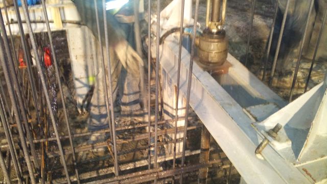

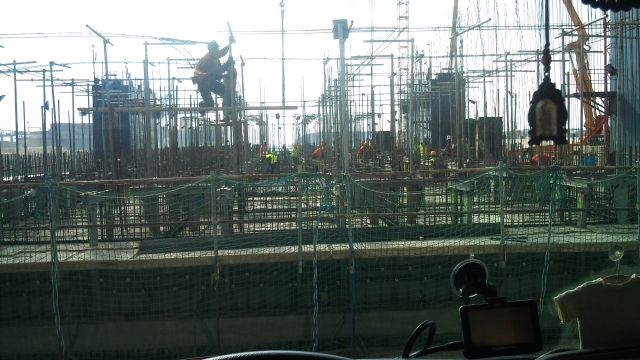

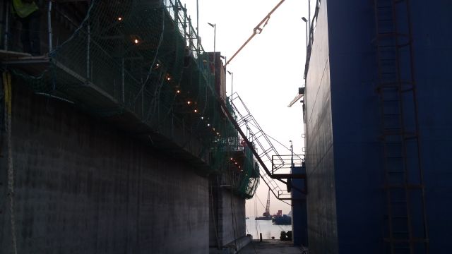

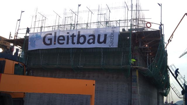

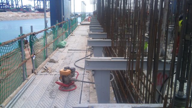

This job needs one think, PATIENCE.The mold start rises 5 hours after the first stroke and the move is 3cm. Now the key is the weather,with low temp 5C-10C we need 60-70 hours for the 9m height, now with 15C-20C we need 44-50 hours. 2 operetors 2 hosemen 12 hours each one at the pump non stop pumping. The concrete is C30-37 [german code] 450 kilos of cement\m3 without chemical. |

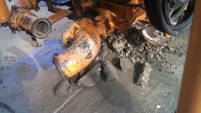

The cleaning with hard way. |

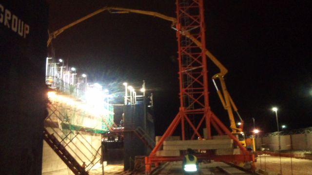

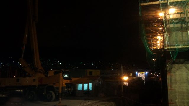

Pumping slow is an art I always say. the cement was a 52,5 cemII I suposse. for slow pumping I preferre the putz above the schwing. If you have the knowledge to fool the computer on the putz it is abel to pump as slow as 5 m3 an hour. |

Yes you right but the mold must be clean that means 1-2 strokes and stop to pass the hose from the moldsteels and again 1-2 strokes and stop. The best part is now this block is 12 separate sections, one to another section the boom must go 5-6m up and down to pass the concrete steel! |

This is what I believe we call a slip form in the US. Raised by hydralic cylinders. They get really boring. But it looks like a big job. Good luck. |

We call that mwethod 'slipform' construction. Most commonly used to build Grain Elevators (or Silos) or the tower for Air Traffic Control. Sometimes for Water reservoirs or 'towers'. |
