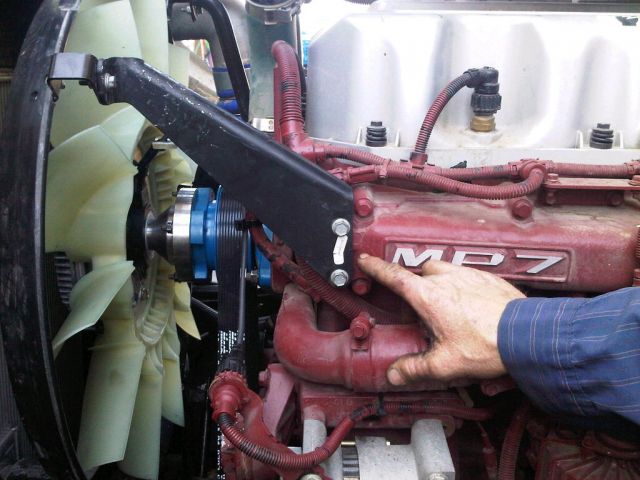

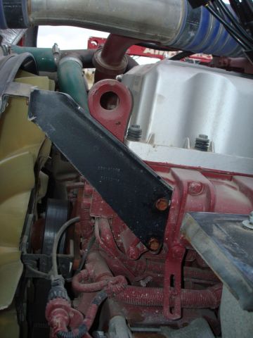

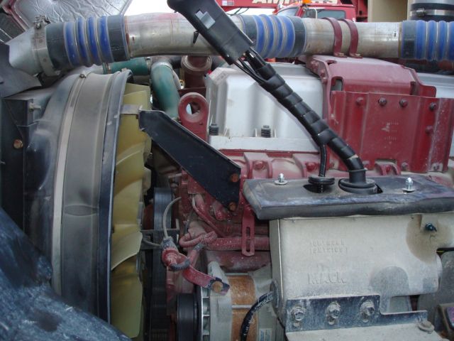

I was at a Mack dealer and learned about a potential problem you should be aware of. There is a bracket on the MRU style Chassis with the MP 7 and MP 8 engine This is the new style design with the after treatment system on them “Regen” On the drivers side front there is a bracket that secures the Fan Shroud to the side of the motor, it is secured with 2 bolts, if they come loose the Fan Shroud can sag into the fan and this causes major problems the fan shatters sending parts of the fan into the Radiator and all over, Picture this “ PUMP OFF” fan destroyed and a lot of other stuff in the front of the engine. PLEASE take the time to check these 2 bolts and the other mount hardware surrounding the shroud it could save you a lot of grief, I have asked several guys to check theirs and most all of them have found these 2 bolts loose.
The fix is this. Remove the bolts one at a time, apply loctite to the bolt and reinstall to the appropriate torque for the bolt size. Then do the other bolt, it takes 15 to 20 Minutes, and can save a job.
This applies to any unit mounted on a Mack MRU Chassis TB or Pump MP 7 and MP 8
If you don’t have a truck of this style tell a friend it will save them. I have taken pics of the bolt location on MRU MP 7 and MP8 |

I just did an engine service on my mack and did notice the bolts were loose as well. I used locktite 242 to make sure that they were not going to loosen again. That is a great tip to watch for. Also I had to re align the fan shrowd as it had sagged a bit as well. |
