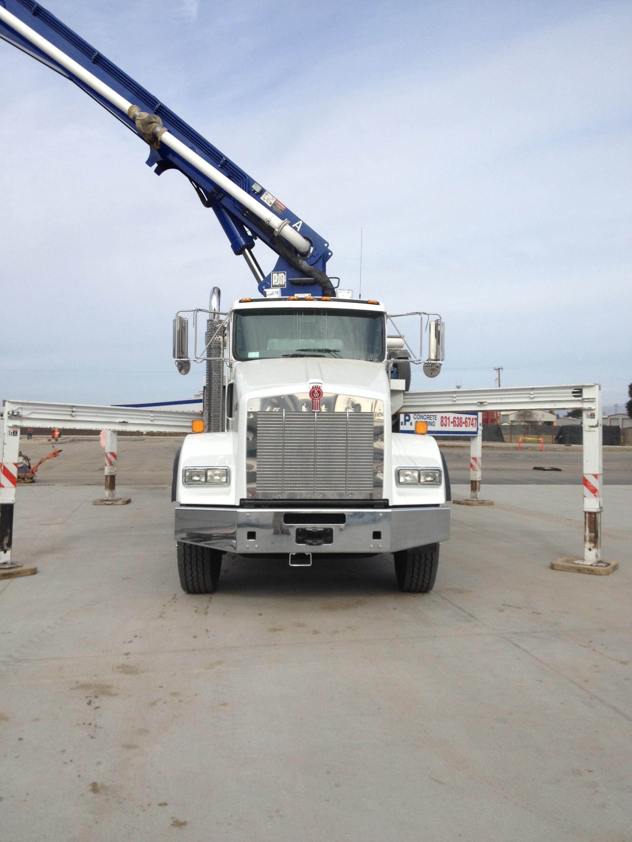

How much boom do you loose goin over the cab of that KW when you gotta go over the front 36m? |
| 36m | 03-26-2014 | reply profile send pm notify |
4-5 ft not too bad haven't run into any prob on job yet because of it......KW has such a great truck , Cummings engines have great power.... So many great things mack doesn't have . A/c works so good it will make you turn it off! Can even have it on low while pumping on hot days so when you get in cab it's not 150 deg like the mack! |
