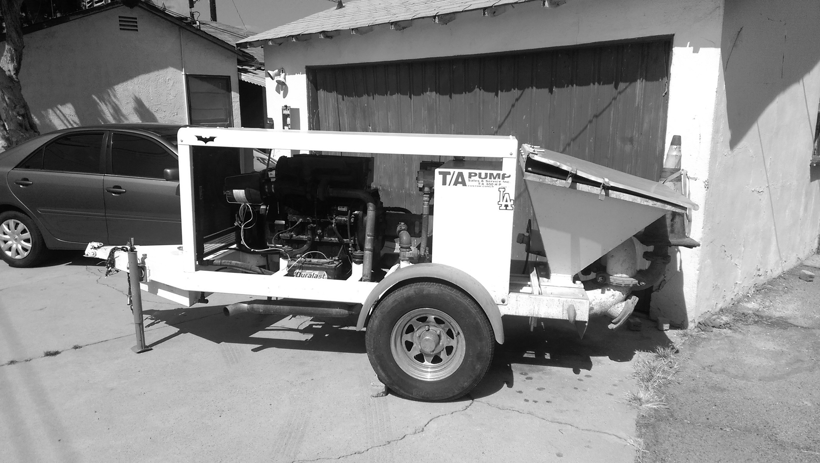

Where in the LA county can I buy one? I only know of one place that might have it in Orange county but I wanted to see where else I can go ... Please hel p me out any thing would be much appreciated |

Build it your self I have build several |
| orygun | 09-07-2014 | reply profile send pm notify |
Absolutely build it with two square stock bars for support then use inch stock for the rack spaced 1 5/16 to catch 1.5 inch rock for your 2.5 inch line. Have shop weld it up and get it powder coated. Did mine in 2006 for $300- for my tk-40 |

just use a piece of square mesh and cut it to size? :0 |

Hey go to a scrap metal recycler and get some 10mm cold rolled screen it works perfect and catches everything so it does not go in your pump and then into your line. I use s screen only if the supplier has given crappy loads in the past and in the winter because you can have frozen aggregate when the loads are batched. However you need a vibrator on your grate to make this work perfectly. |

In a pinch a piece of chain link fence works. |

I used to just buy a chain link gate from Home Depot. 2 bungee cords will hold it in place and it's super light, unlike the one I welded out of rebar. That sucker weighed a ton! I also put a 2x4 on end and the back of my hopper to raise it off the hopper creating a flat surface. |
