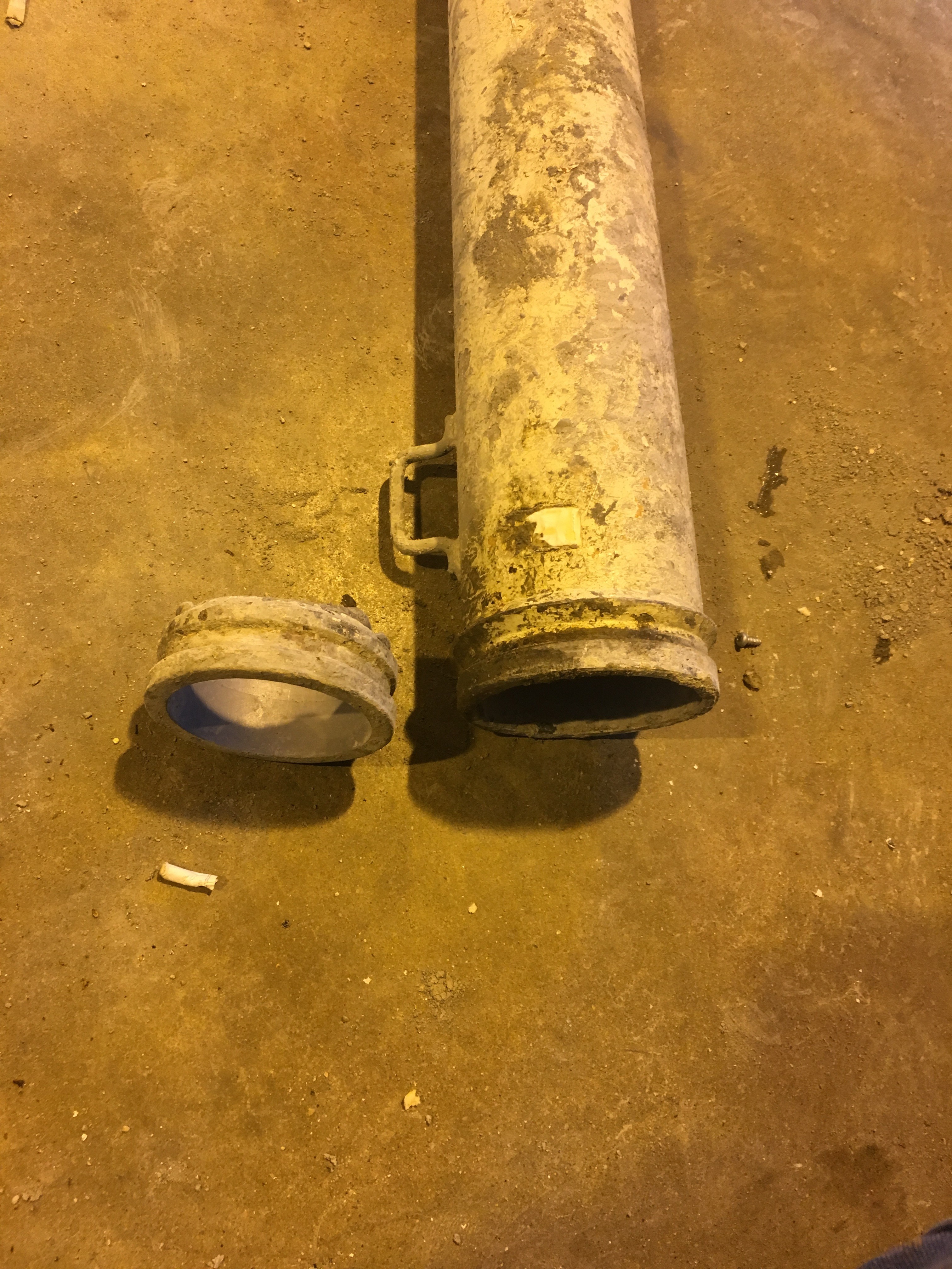

Need new reducer web site asks metric to hd or hd to hd I’m thinking metric is the boom ends and hd is for discharge hose so I need metric to HD but don’t want to order wrong. Any help would be Appreciated |
| mudpumper | 11-24-2018 | reply profile send pm notify |
Everything on your boom should be metric flange and 5-4 reducers should be 5in metric to 4in HD. Unless you or previous owner on a used unit has changed something in the past. |
| pudg2 | 11-26-2018 | reply profile send pm notify |
metric- H/D , I have made change overs and use H/D to H/D |
