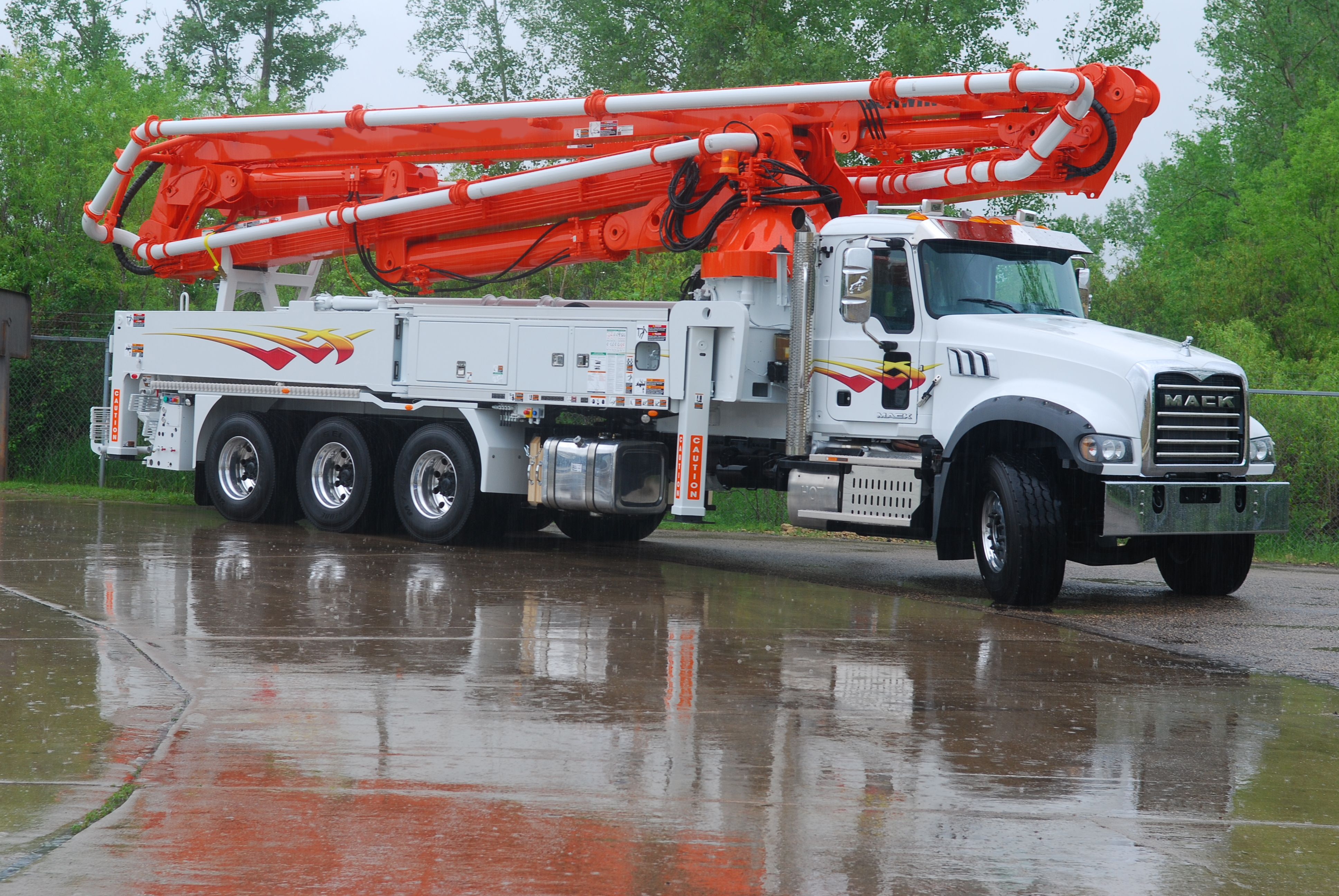

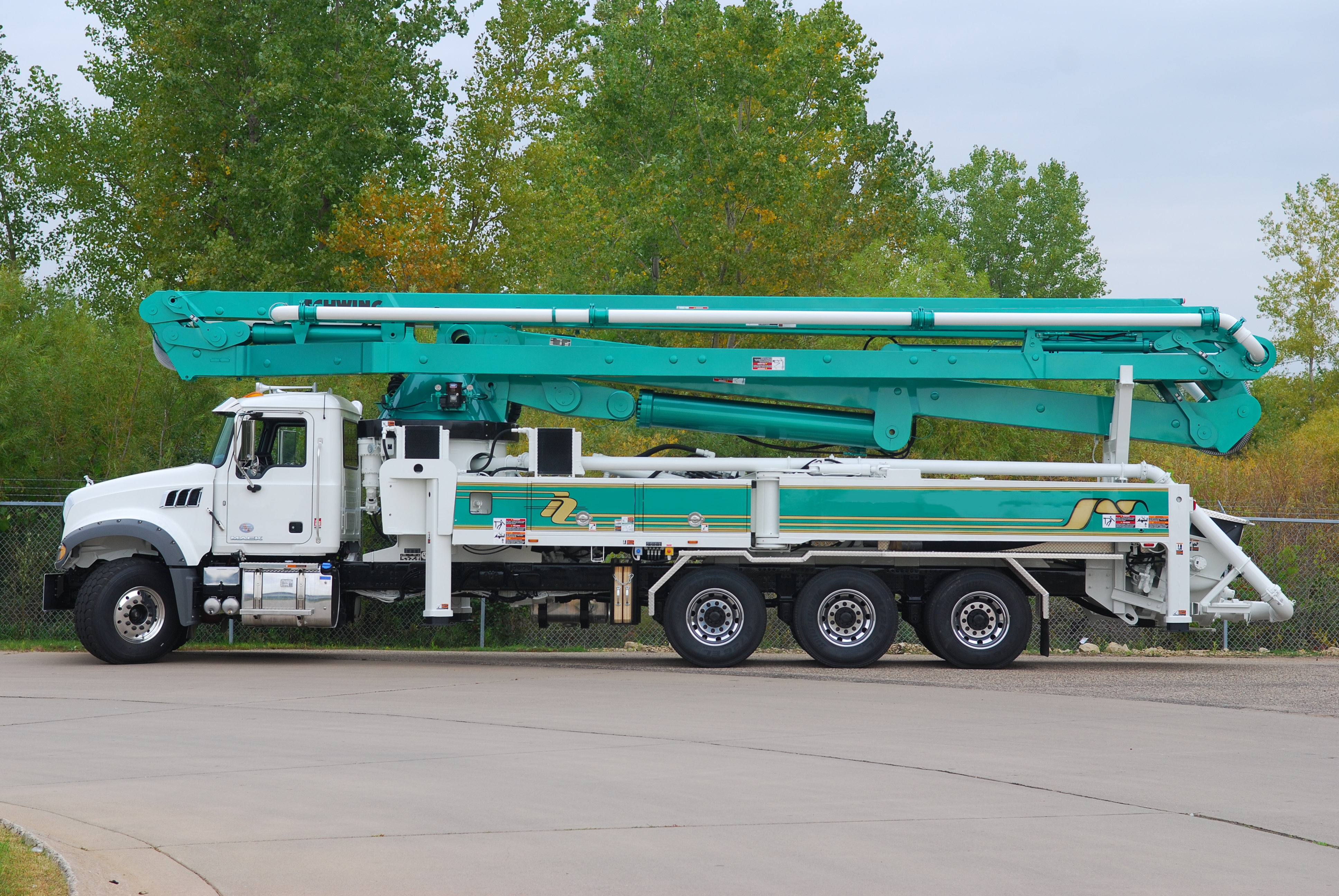

The Schwing S 46 SX is now available on the Mack Granite (GU 714) chassis in a single steer axle/tri drive configuration - with an automatic transmission. The Overhead Roll and Fold boom is popular among operators - with its Z Fold second section, operators can get this 150’ boom almost anywhere. Owners will love the Mack factory warranty - two years / 250,000 miles on the engine, and one year “bumper to bumper” unlimited mileage on the chassis. Operators will love smooth ride, the automatic transmission, and extra room! You definitely lose some reach over the cab (36” to 42”). Give us your opinion. What are the pros and cons of conventional chassis for concrete pumps? |

The 6" of reach loss at that length to me is not an issue. The tri drive is harder on tires. The bigger cab is a bonus. jmo |

I like the idea, but the longer wheel base of that truck (compared to a cabover) combined with the low rear departure angle makes me think that truck would be making three point turns and dragging the bottom of the hopper all over the Jobsite. It looks awesome though I'm sure it would be great on the highway. I am also a big fan of the newway air bag Tri drive rear suspension. We have it on a couple trucks and it's less headaches than broken springs and worn out rubbers in the mack camel back suspension. |

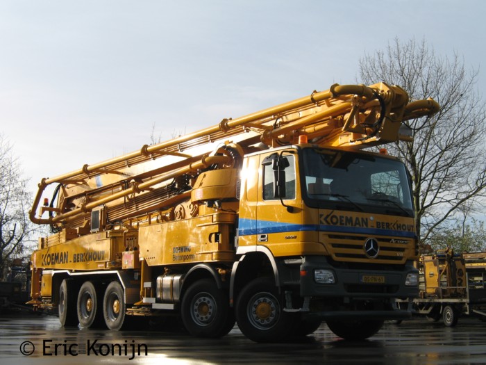

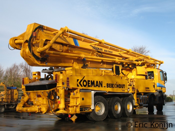

Ok it is a step forward, but stil two decades behind. whit a stearing rear axle you can go almost every where you want. in this setup I even made it to the cannals of Amsterdam center |
