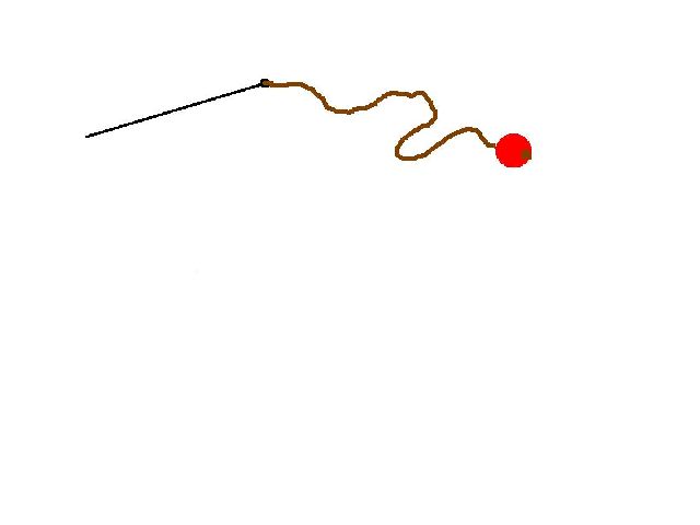

Here's how I clean out hoses when I'm on upper decks. I don't want to wait 3 hrs until the jobs over to clean my gear. So, with a 5 gallon bucket of water and a brush, I can clean 30+ hoses. Take a piece of 2-3' rod or rebar and weld a washer to the end of it. At the point where the washer is attached, tie a rope - make it however long your hose is that your cleaning. On the other end of the rope, poke it through a sponge ball--and tie a not or put a washer on the backside of the sponge so you don't pull the rope through the sponge. Now you can send the piece of rebar through the hose, the weight of the bar and the inertia of your push will get it to the other end. pull the sponge up to the hose and help it in the end. Now you can pull the rope and the sponge will clean the hose perfectly. The brush and water is for the hose ends. The process takes less than a minute. Now I can put the hoses aside and not worry about the contractor flying them to the ground for me to wash. Here's a really crude drawing of my set-up--
