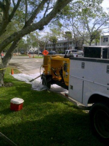

Well today we had a major issue in the middle of a pump. I did not relize what was excatly going on until we were finished, but I suppected something. Nothing unuseal, 125' of line and only up 7 feet. It was pumping like I was up about 600 feet though. Coming in short burst and having to up the throttle to get it flowing. I could see the S-Tube gague from where I was, and it looked a little low. We finished the pour, there were only about 3 yards left when I noticed the issue. While cleaning out I gave it all a good look. The S-Tube was barely moving and only getting about half of the concrete that was in the cylinder. The pressure was only about 500-600, not the useal 2500. Drive pressures were good for the material that was there. I washed out, and checked it again, and it was still doing the same thing. After I got it home, I checked it once more, and still the same thing. I think it a little more than a filter. I am starting to think its either the S-Tube hyd cylinder or the control box. This must have been devloping for the past month or so because I thought everyonce and a while that it was "short stroking" but could never find the issue. It is going to Earl, the man we bought it from, in the morning as it is only 3 months old and is well within its 1 year warrenty. It has 209.0 Hours as of today and between 1200 and 1300 yards though it. Picture from today, not the best place to set up, but the only option we had. |
