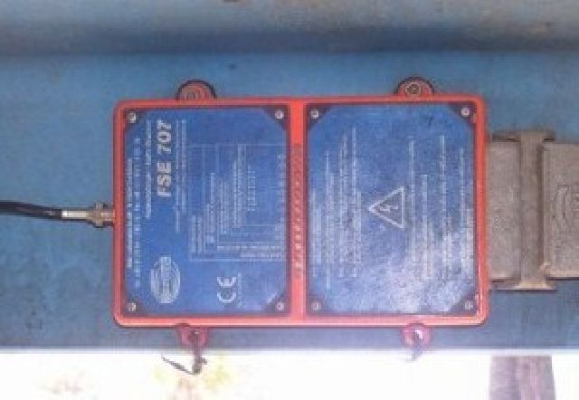

I've been pumping for a year I got a line pump tk 50. the remote seems to loose signal when i go below a certian elevation even if im twenty feet away, but straight ahead it will pump with no problem as far as a block away. I got a new battery for $180. and still the same thing. |

need a little more info had a hbc boom remote you had to keep line of sight with or it would lose signal need to know location of your transmitter a pic would help |

it is a hbc, the reciever is under the blue engine cover but i put a new antenna on top. |
| pudg | 05-21-2009 | reply profile send pm notify |
I would definitely move my antennae to the top of my pump it is kind of hidden put it out in the open should help. |
my bad didnt read your post with the pic,sometimes if your transmitter struggles to find the reciever it weakens your signal strength that I would send it in and have it checked. |
| mrmike36z | 05-21-2009 | reply profile send pm notify |
We had the same trouble with our tbelt. You couldn't get more than 20 ft or so away and it would loose signal. I called Putz and they said something was wrong in the reciever. Sent it in and they worked their magic and walla fixed. Call radio repair and ask. They will send you a loaner remote while you send yours in. |
