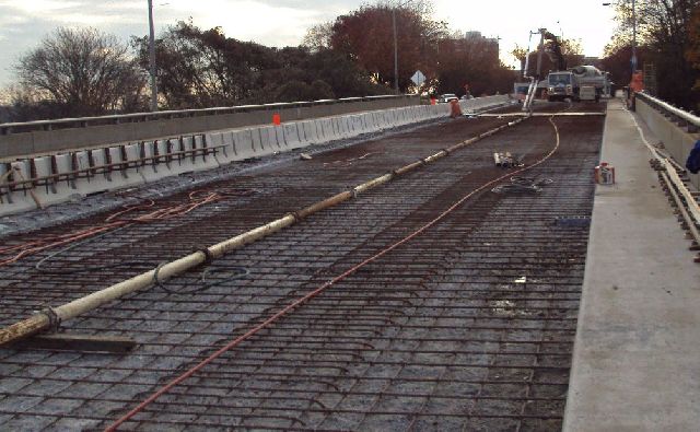

nice vids bill, what was your pressure reading? 250-270? 310 ft of system nice long push. haven't done one like that in a long time...pump on brother |

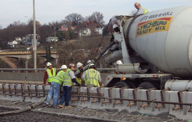

What's the first picture signify? Did you prime with grout and that's the disposal (or maybe re-use?) truck? Add the grout back into the 3rd load of mud? |
| PourItOut | 11-30-2010 | reply profile send pm notify |
Pumped the grout into an empty mixer |
| pumpjockey | 11-30-2010 | reply profile send pm notify |
I.C. Thanks. How'd the prime go? That's a lot of system. I'd think that it would have to be a very creamy grout with LOTS of powder to slick up that much line. For me, with 200 feet of 3" system, it's pretty damn dry by the time the first stuff comes out. I found my last prime with bentonite to be better, actually. |
100, gallons of water and 2yds of 10 sack grout, straight cement,,, Rick, 240 to 29o bar going in the hopper at a 7" slump,, 5" on the receiving end!!! |

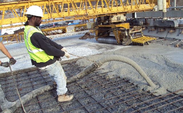

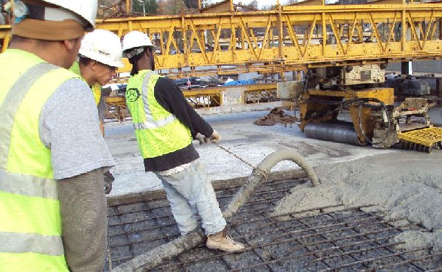

We supplied 4 men to handle the pipe and hose,,, tough job,,, customer satisfied, thats what matters the most
