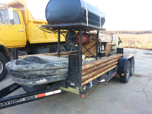

Here's a pic of my rig about 200' of pipe and 150' of hose. Quick dump from 250 gal tank to hopper and to run 4300psi pressure washer. also about 150' of garden hose to find a hydrant if needed |

nice rig. all we do is line pump , so i can apperciate a set up like yours. |
| crete | 04-14-2014 | reply profile send pm notify |
Stole the water tank and quick dump into the hopper from "Big Ed" in Clarksville TN. Also pressure washer on the rig. So do you also water wash with a pig or sponge from your hopper after washing in out? |
| SRC | 04-14-2014 | reply profile send pm notify |
man thats a nice setup I wish I could do something like that I have to cram everything on my finish truck |
