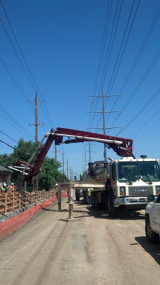

I found this picture up on facebook. here is the caption.
Safety inspector says "you know you have to be 17' from those power lines" I say it looks like 17 you should climb up and measure in between them... he left lol
Doug 05-16-2014
Actually it's 20' now.
rusty22 05-16-2014
And the rule is really,the boom can't reach within 17' or 20'.
ShortStik 05-16-2014
ha, ha ha, hahaha, haha okklol.  the boom cant get any lower than 3.8 m
Doug 05-20-2014
BTW - Those transmission lines above and behind the pump probably require more than 20'.
Trey 05-20-2014
It doesnt say your boom cant reach the 20', it says if your boom can get in the "danger zone" you must have a dedicated spotter.

Why don't they just pour out of ready mix truck? Oh wait I see it now. They would HIT the electric line with their truck.
AZ pumper 05-22-2014
Change the mix to 1/2 inch and use a line pump
