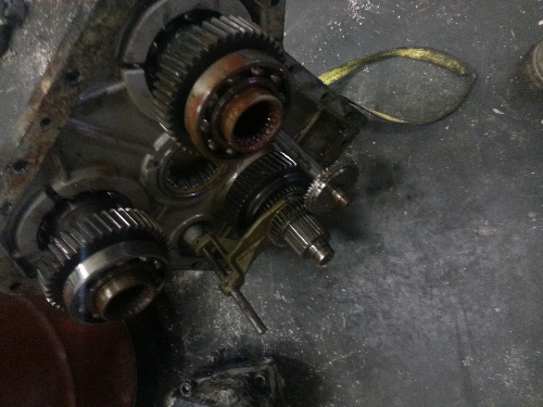

| Mister_Perkins | 08-07-2013 | reply profile send pm notify |
the accumulator pump was seized in the steibel box and when we finally got it out we found more problems.. worn out stuff. so yeah now its a since were in there might as well fix it |
