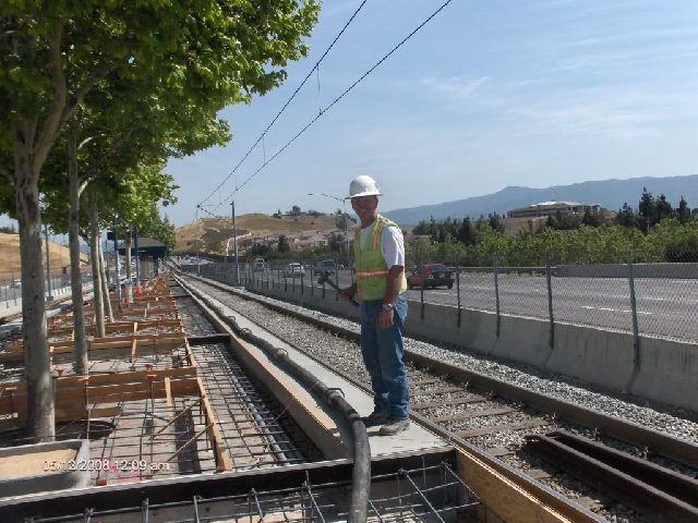

Ok Pour it 0ut. here is one for you. I think of safty first!Here is one: This job they wanted over 700 feet of light weight system for 90 yards. They would of have to close the highway for their pour during commute time so, "THEY ASEKED ME WHAT COULD BE DONE"! They wanted not a 4 inch but a 3" system with a max of 5.5 inch slump at 700 feet. I told them I am only going to do it once and use the newest system. We had a drop shipment of 200 feet of new hose which they had to pay for. IE: SAFTETY FIRST!! The pressure would exceed 3800-42--- on a TK CATCREATER. No one else would attempt it and we where paid 325 per hour and bill was for 9 hours set up till clean up three men. End of story for system. SO YOU ALWAYS THINK OF SAFTEY FIRST!!!! . Point is you do not think you can do the job you do the job knowing you covered your bases for all safty issues. Anything can happen and the yahhoo's will get it in time. ps. i have puimped 1/2 a mile |
| sammy | 08-21-2009 | reply profile send pm notify |
