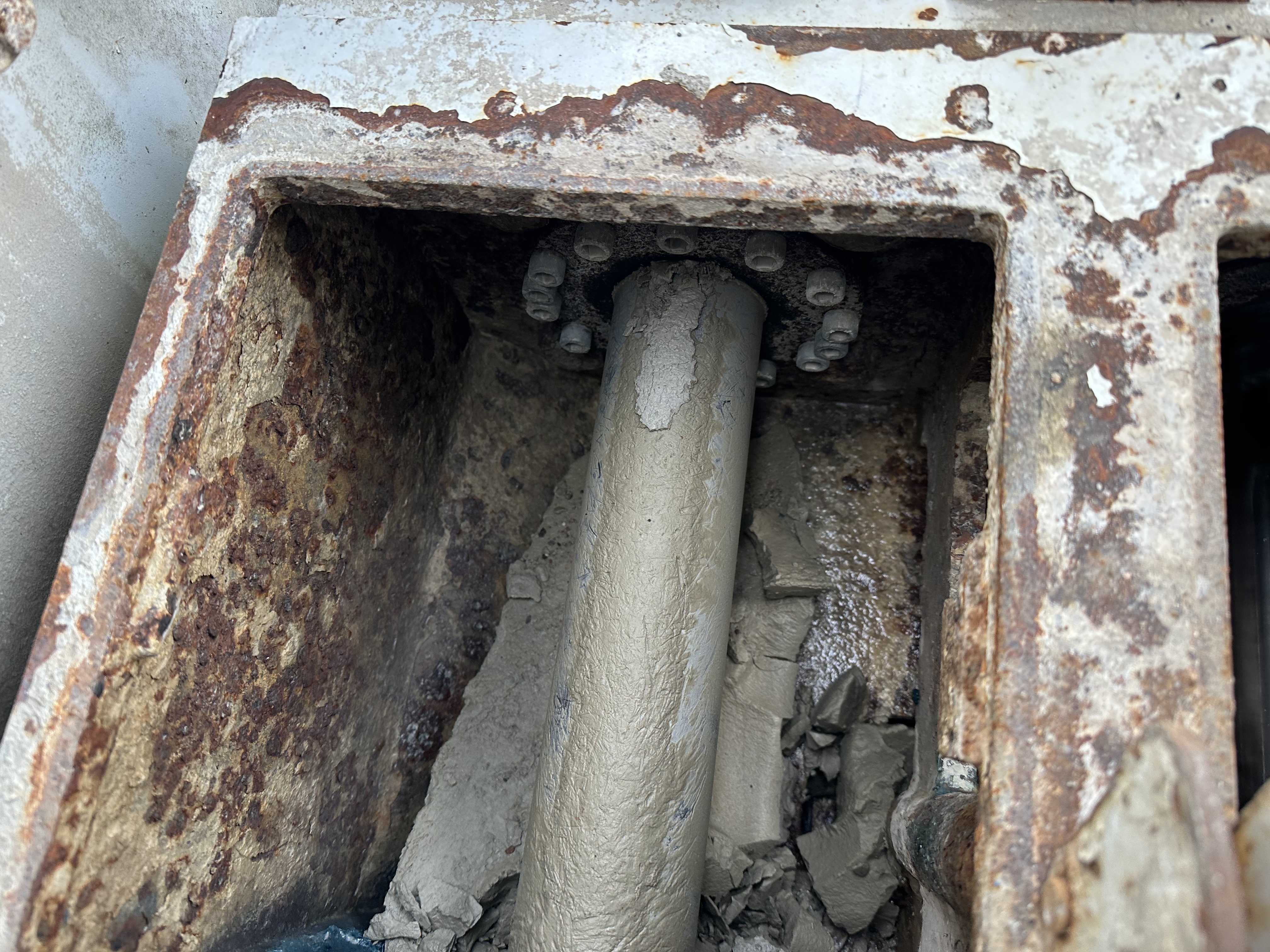

How much fines should build up in your water box after half a day of pumping with healthy material cylinder and rams? I pumped a really wet mix and drained the water box quickly. Maybe a little bit in the bottom. I came back the next day it was all caked on the mud cups and on the chrome near the mud cup when I cycled it. And filled about 1/4 of the water box with grout turned into balls. Is this an issue ? |

I asked ConcretePumping.com AI and here is what it said. Water Box Maintenance for Concrete PumpsBased on your description, here's what you should know about water box fines accumulation: Normal Accumulation
Your Situation AnalysisWhat you're describing—material caking on the mud cups and chrome, plus 1/4 of the box filled with grout balls after a day—suggests:
Recommendations
Regular water box maintenance is crucial for cooling the differential cylinders and lubricating the rams properly. |
