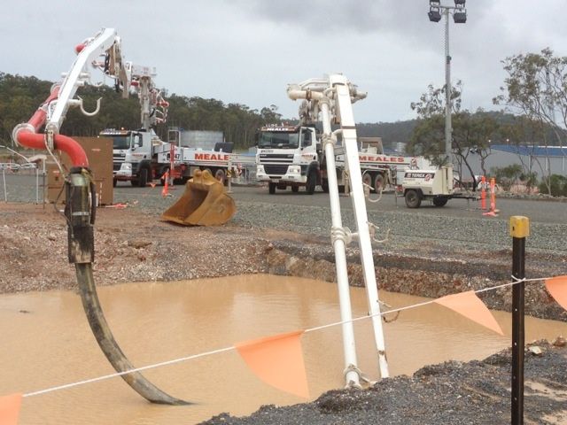

No concrete to pump so why not |

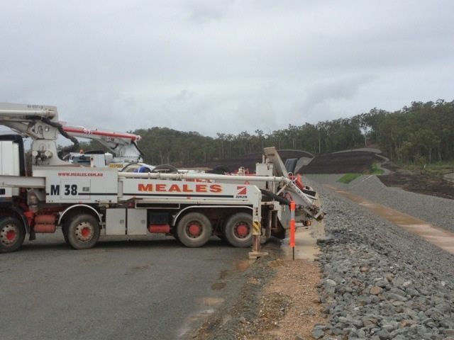

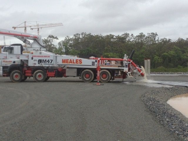

One 47mtr putz and a 38 mtr jun jin. Made sure we greased the S-tube often |

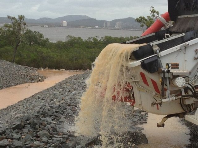

Easy clean up :) |

Please tell me what you are doing |
| creamy | 03-05-2013 | reply profile send pm notify |
There's been a lot of rain on the eastcoast of Aussie so our job site flooded if the boys can't get to work we don't work either. To speed things up we used our pumps in reverse to suck out the water, pumps earning money, I'm getting paid and its better than sitting in room back at camp. |
