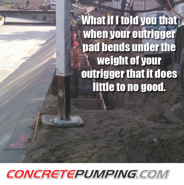

Please make sure you use enough cribbage under your pad to support your concrete pump. 9 out of 10 concrete pump operators who flipped their pump over wish they had used more cribbage. |

Well yea that makes total sense. When your pad bends it's no longer distributing the weight of your foot...so essentially it'll push the pad through just like it'll push through soil. |

Cribbage is a game, the correct terminology is Cribbing or Blocking. 1926.1402(a)(2) "Supporting materials" means blocking, mats, cribbing, marsh buggies (in marshes/wetlands), or similar supporting materials or devices. per OSHA.
I call it dunnage, always have always will. The important thing is to do it, not wether you know the correct word to define it. But Cribbage is always a game. |
