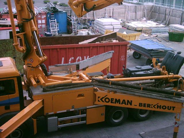

I carry a lot of stuff in my truck. I got spare for everything, tools, you name it. Every possible place is taken up, I'm talkin' dash full, under seats full, tools box exploding full, line pipe, reducers, flex line, dont get me started about dunnage, but some of you guys even have more!!!!! So heres the question "where do you put it?" And I'm seriously asking too. I would like some hints please. For example, somebody(can't remember the company)had some cool hangers for reducers on his outriggers, I would like to see that picture again

How much can you load on the truck and still have it road legal, in sweden we cant load much on pumps over 36m, the law sucks. |

wayyyy to much hose on that truck !!! Maybe one of those longer hoses but not all of them you own. Plus welding stuff to your outriggers changes the structure of them and without written authorization from the manufacture you now have full liability if something goes wrong with them. Would'nt it be easier to just know how much hose you need for the day ,rather than carring everything you own on your truck ? No offense Mr wibau, but i would call this a safety hazard and recomend it be removed if I performed a boom inspection on this truck.For two reasons, #1 the clutter and for #2, the welded brackets on your outriggers. ( Im assuming they are welded ?) |

dear sir, mr boom inspector, please browse brendan's photos and you will see he uses this much gear and more on a very regular basis, he does not carry it all, there is still some at the yard. as for the welded brackets, the right people have seen them, come on over and have a look if you want, your most welcome cheers steve |

Thank you Steve for the feed back. And yes Mr.wibau has some great stuff added here. In that I do agree. But for "arguement" sake, lets just say the brackets are welded on. Since the out riggers are a structural component of this boom , I would hesitate without a written authorization from the pump manufacture due to liability reasons. (this covers your ass "just in case") I know he or his company owns the pump and can modify it as they like.But if there ever was a failure the investigators first comment would be about all the hose and brackets installed that appear to be non factory issue. Yes what he has done is innovative and saves him alittle time when he has all his system on his truck,but you also have to look at potential future problems when doing this with a boom truck is all im saying. Thanks again Steve your comment was appreciated |

You dont have to weld your equipment to your outriggers the manufacturerer has always some points you can bolt them in |
| Boom Inspector | 11-15-2009 | reply profile send pm notify |
There ya go SUPERDOFFER,that is a perfectly safe alternative . I wish I had thought of a picture myself. Kudos for adding it on this thread. |

My Putz has a similar setup as yours SuperD, think it came from the factory with it. |

gee where do i start, firstly i need and use these gear very often so it is very needed to be on board. boom inspector,how am i to know how much gear is needed when i concrete does not no the difference between 50 and 150meters they are not all the brightest.also what has it got to do with anyone how much gear i carry as it does not slow the truck down and i am the one that has to sort throuh it. as for the welding as 2ic said it said be checked and safe and sound. welds are only at top and bottom not in the middle only where the welds are for the legs .more then welcome to come and have a look. thanks kiwi. telealbelt thats why they invented truck trucks. supperdoffer how am i going to fit all my gear there. while you are up there next time stap it down as it is not road legal. pump noob is prob gets more care then most pumps as the gear is taken of offen so i am in there more often. then i give it a bath while it is of everytime while waiting for crete. pumps are hit hard here work cover is right on to everything. boom inspections every year and full stip downs every6 years. plus a hole heap more stuff like cds said.

Thanks Mr.Wibau for clearing this up for me, if the add-ons were welded only on top edge and bottom edge of the outrigger box where existing weldments were located along with proper pre- heat procedure followed along with the proper weld rod being used . I could see why others have approved those hangers in your area. But I seriously would not recomend doing this to your pump ,In my opinion your left hand out rigger is getting to much unnessasary load from open/close process and your main pin/bushing will show premature wear in time. But hey it is your pump and your responsibility right ? Ok ,lets move on to what CDS has said about Australian Boom Inspection procedures. Does your company and all others there have to follow the guide lines CDS posted ? If so do many of the companies there just sell there booms after 6 years rather than do the "tear down" ? Are Inspections mandatory or voluntary there? Could you give me and the others reading this some insight about your experience with Boom Inspectors in Australia ? Im just very curious as to exactly why someone there decided all Booms needed a tear down after 6 years of use is all. Thanks again Mr.Wibau, I really enjoy your postings here |
