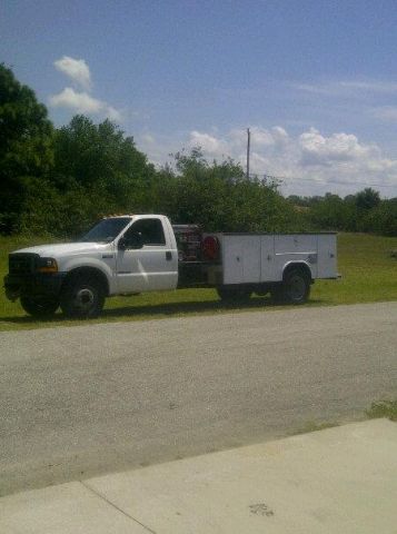

I poured 4" slab yesterday at USF St. Pete with our little line pump. It was supposed to be a 2 day pump, but Cemex had a rather large order on day 2 and asked if we could do one day. Sure why not. Pour went smooth once we got the clump of rock out of the hose's. It's always the first bit that pluggs the hose. The only other issues we had were late trucks. We could dump a truck in 20 mins, but after 1000 Hours trucks slowed down with almost 45 mins in between some. Cemex eventully pulled drivers out of other plants to cover. We finished pouring at 1730after starting at just before 0800. Pump did well, used about 19 gals of fuel. I regreased it about half way through. Only problems I forsee pumping that long is cleaning up afterwards. I spent almost 2 hours scrapping and chipping away and it still is not as cleann as it was before. That will just take a day of cleaning only, if I ever get one. Now I am concerned about the plate in the hopper that the S-Tube rides aginst, it has developed some scoring on it from the constant switching. And the Right side Drive Cylinder squeaks every stroke like a old door. It pumps fine and there is no signs of excessive wear other than that. I have 2 more big pours tomorrow morning and super early Monday, I will see how it does. My biggest concern right now though is my F550. Besides the oil in the radiator, my A/C Compressor blew up last night right before I went to leave. Man was it a hot ride home. |

I think if you put a little soap in that cylinder it will stop the noise, and the marks on you cutting rink could mean its to tight you can loosen the Nut on the S-tube about 1/4 turn, how old is the F 550 I pull with a F 350 V-10 |

The scratches are normal wear marks and the noise sounds like mud cup wear. Soap or a bag of snot-slick willy or what ever you use to prime. |

It is a 2000 F550 7.3L ZF6 Speed 4x4. It has 203K, last 10K in 5 months pulling the pump and other heavy trailers, and it is on at least its 2nd trans. It has a rebuild date of 06 stamped on it. We bought the truck from United Rentals in 08 I think. It became the service truck and our manchainc was very easy on it while he drove it. He said he was not gonna drive it anymore because he could not handle the size anymore. Then it sat some, he never drove it much to start with. After that it became the Pump Truck. The oil in the coolent is pink but feels and smells like engine oil. Thats all it could be. Being a manule trans there is no trans cooler. We think it is from the oil cooler leaking, so we are going to start there. We hope its just the gaskets or the cooler, cus if it aint, we have major problems. As far as the A/C goes, we put almost a hole can in it, and it seems to be holding. The high pressure valve will blow again, but hopefully then we will have enough going to justify the fix. Otherwise the pump guy is gonna die of heat storke. It also has saggy front springs, a common issue, along with bad shocks, and its out of alingment. Got new steer tires though and now have a spare. I think all of the issues that are happening are from the now constant use and all the abuse it takes from the pump. I was watching the CB Whips I have today, and they were shaking really good.

The rear springs are fine, the fronts though look like they were installed upside down when I am hooked up though. We all know it needs new leaf springs, but when the big boss man will not even spend $300 on his on car on stuff that it needs, you know money is tight. That and it will be down for 3 or 4 days. |
