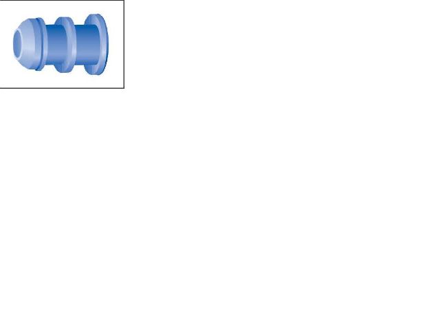

why go thru all this trouble when a go-devil passes so smooth and its cleans as a whistle , I know on the newer 4 1/2 inch inside diameter we use sponges but everything else we use go-devils works like a charm and there idiot proof , if it comes back its clean.

Hey pudg- I have never heard of the go-devil. Can you or somebody explain what that is??

Thanks 52putz! What is it made of?

Have you ever had issues sucking back a go-devil in a boom that has a mix-n-match of old and new pipes/elbows? Would there be potential for it to get hung up on a ridge created by a new elbow feeding into a worn pipe? I have never used one before and am curious... second question, what is the cost for one?
