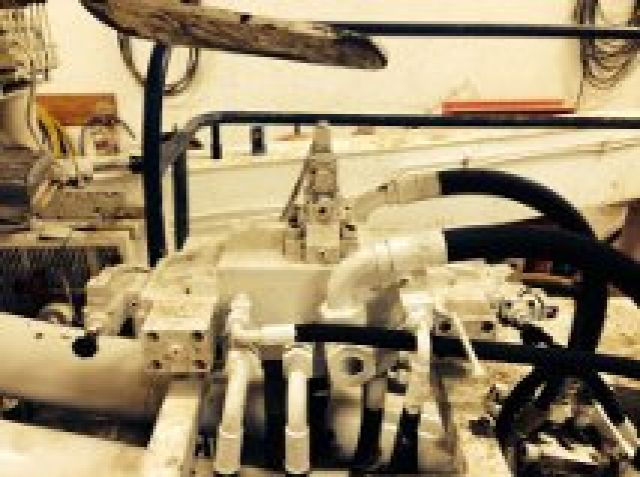

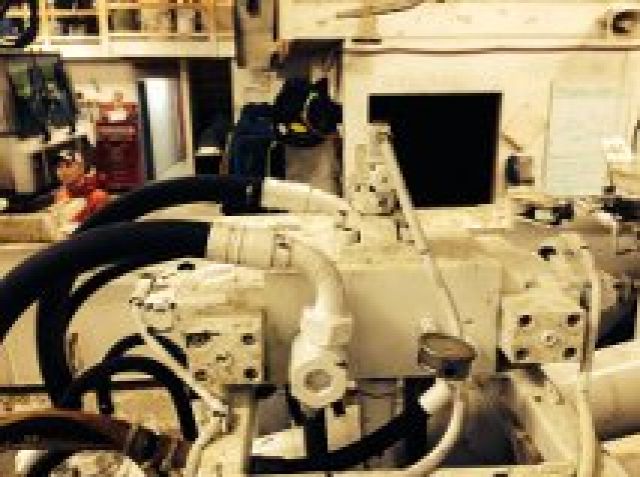

here are a few pics there are 2 manual/12volt valves that can turn and lock down one on the back and one on the front What should each one do? should they be in or out? then there is a valve on the top what should it do? there is 2 shut off valves one to the rear S-tube switch ram and one loops back to a drive cylinder should they be open or closed? |
