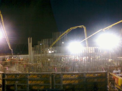

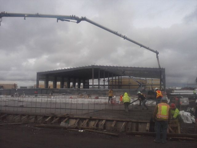

30 consecutive work days to get this slab down. The days we didnt pour I operated misc. other equipment for the builder. The local redimix company consisted of 3 mixers and a dry batch capable of delivering a maximum 30 yds per hour. Largest pour was the last shown below.... 330 cu.yds. |

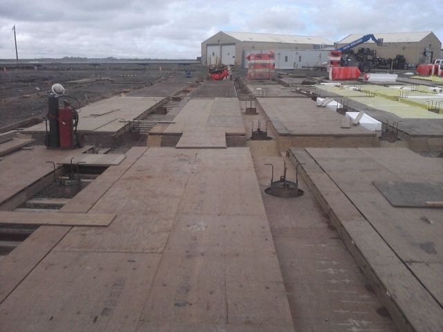

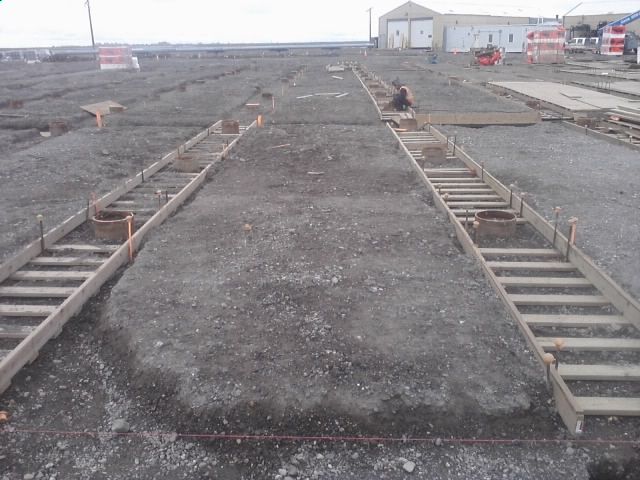

A "floating slab" built on pilings driven to refusal... |
| TooTall | 08-31-2012 | reply profile send pm notify |
...with an extensive subgrade deck made of pressure treated lumber... |

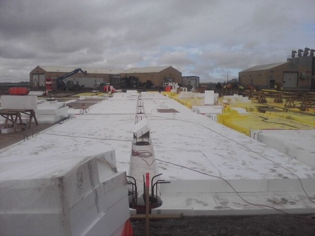

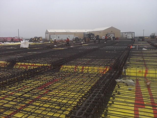

...With 12" foam insulation glued to the wood deck. |
...Covered with a super heavy duty plastic vapor barrier. |

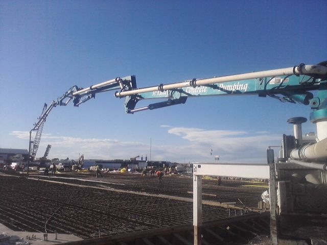

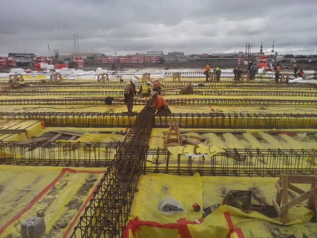

...And a Massive double matt of 7 bar with grade beams welded to the pile caps... |

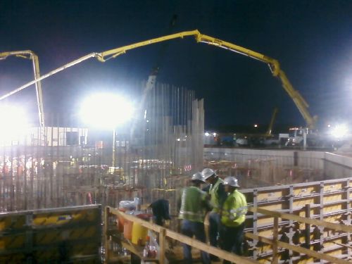

20 pours, all pumped with a 34m Schwing without a single glitch or hiccup. She didnt plug one single time and the pressure guage never broke 100bar!!! |

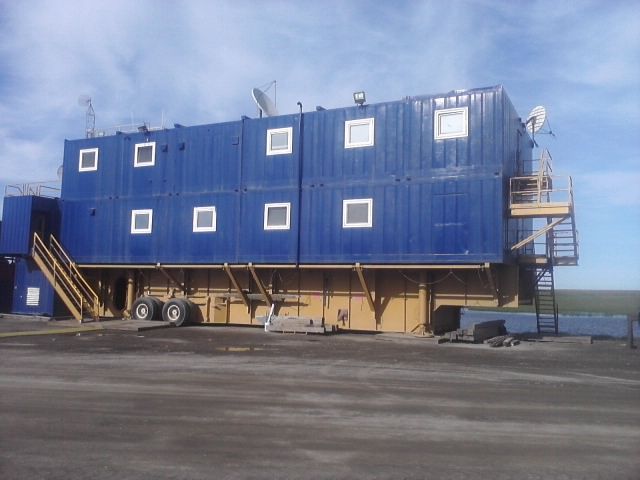

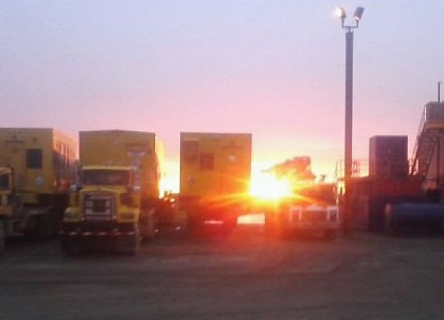

The oil rig camp, totally portable, complete with its own outriggers |

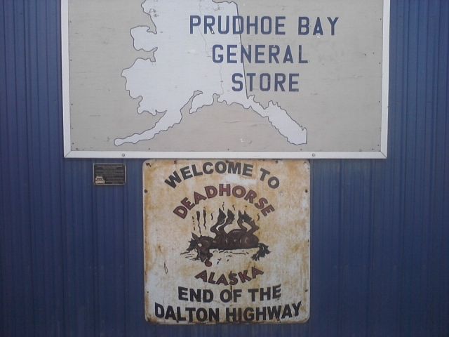

This place is an Industrial Mecca that never sleeps! At the airport there's a sign that reads.. "Welcome to the top of the world. Everyone south of here either didnt make it, or couldnt take it!" |

Not surprised the pump worked so well. It was a great little pump when I ran it. Alaska mud pumps like butter and makes a guy look like a hero. I'm down in Juneau now. Thanks for the pics Rob. |
