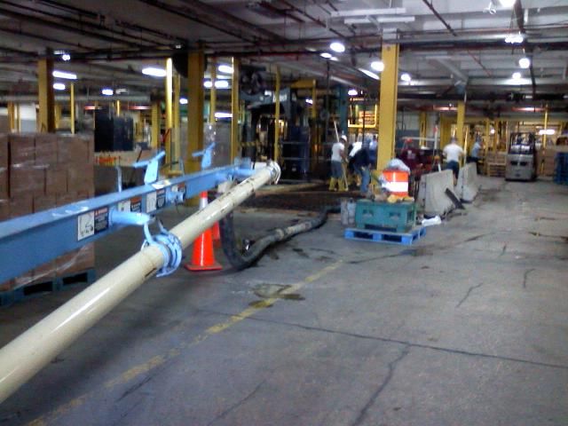

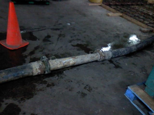

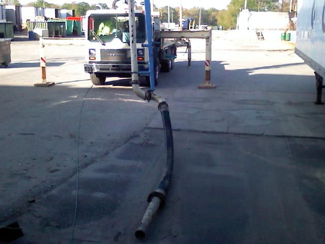

Wow i do have a reducer |

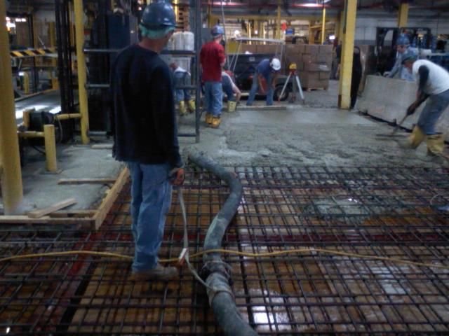

I understand the beard net but why the hair net i shave my damn head!!! |

Whats the net for? |
| Boom Inspector | 04-19-2010 | reply profile send pm notify |

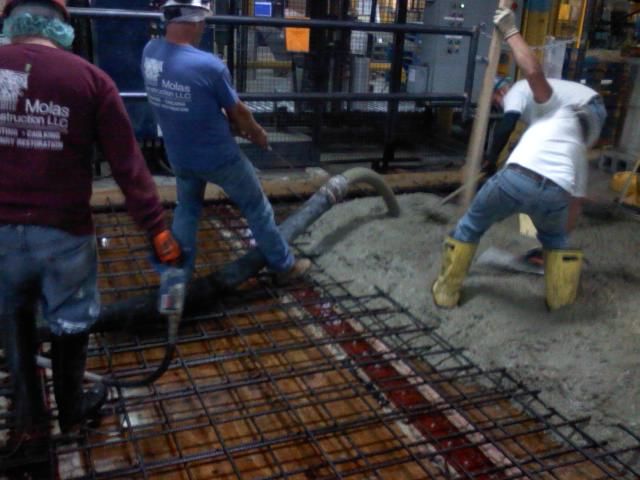

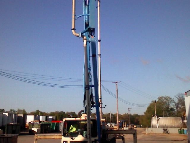

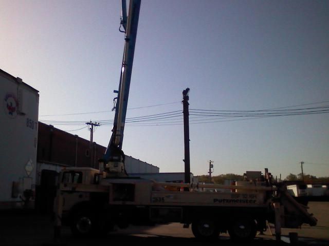

Nice pics Mudcup, looked like a good days work.Ive worked for process piping companies before as a pipe welder and i know all about those dum rules about hair/beard nets what a pain when your welding not to mention while you are pumping. |

Looks like you missed some. |

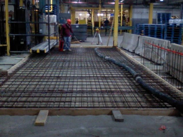

I'm A telebelt guy ,but how much hose is to much as compared to pipe as for harder pumping. T |

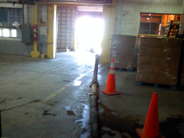

Nice Job But Why a double ended hose at end just becouse its on the ground doesnt meen sh?? cant happen please use whip hoses at end hose just for safety thats what a lot of use should be trying to talk about on this site think safe be safe no metal on end hose |
| mudcup | 04-20-2010 | reply profile send pm notify |
predader so your telling me if you end up taking off line you should put a hose with no end on it every time you take a piece off you guys are nuts im not gonna put anymore damn pics up here all you guys do is is talk about how everybody else does it wrong.I cant win no matter what i do |
| pumpjockey | 04-20-2010 | reply profile send pm notify |
I have a 'placing whip', and that's exactly what I do, pull system off, and add the whip back on, never use a double ender. The whip is a longer length, and it's been worked so much that it's nicer and pliable. The guys will bring it back into a figure-8, even. |
well i do see where you are coming from, but i dont have access to one we dont do much line jobs 7 yrs. and ive never had a problem i take it nice and slow |

I did a couple of jobs for Bushs Beans and had to wear that same crap on my head and chin.pain in the but.great pics keep em comin

Like drag racing....run what you brung. Be aware of the dangers, and let the others involved know too. run a little slower to give a chance. let the boss know there is a better, safer way and evolve.
Keep up the good work. strive to do it better. no harm, no foul. we can be a little tough at times, but don't fall behind the curve.

haha nice pxt mate, now you have learnt how to use the reducer, try using the next size down. look after your back mate you only have 1. |

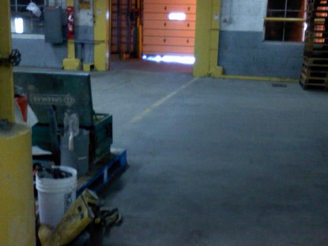

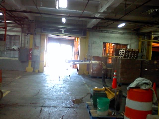

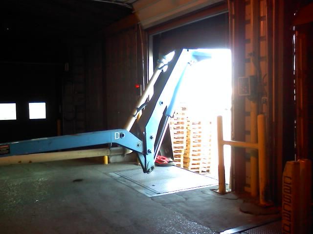

Mudcup just a litle tip. take more distance fom the door,than you can reach to that floor whit your pretty boom.Disconnect al the hose let the last few gallons drip outof your boom bal in side, connect blewoutcap and out whitout aney mes on the floor. |
| mudcup | 04-21-2010 | reply profile send pm notify |
superdoffer thats what i did i had two full sections of boom in the loading dock door and i blew the line out with air and sucked a sponge back im good to go |
mr w i will not go lower then 4" line from a boom pump, that's allot of head pressure your going from 9" to 3" i ain't doin it, i think that's to much reduction not to mention have you tried to push 3/4 stone through 3" line it ain't happening to easily thanks for your input though. |
| Mr wibau | 04-21-2010 | reply profile send pm notify |
hey mate it is a concrete pump and is designed to concrete. dont worry about head pressure have you not seen my pxt. also i pump 3/4 through 3inch all the time. i mean get a 3 and a half inch hose trust me just try one. |

Blowing flex line with air is a disaster waiting to happen,all the hair nets in the plant won't protect you from the lashing you could receive from that snake. |
