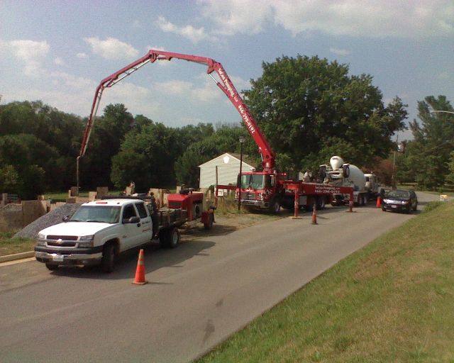

PumpKid_88 | 09-06-2010 | reply profile send pm notify |
me in the traler tk-50 and pop on a 36 putz z 2 walls side by side |

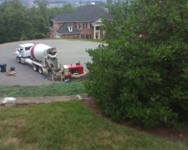

pump str8 up 2 n a half inc hose 7 yards frist truck wen i got to va |

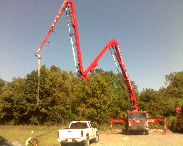

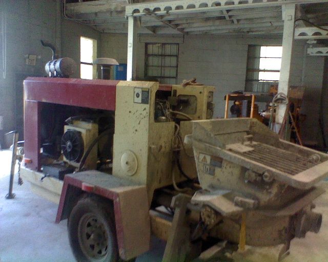

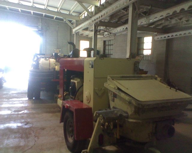

im sure gna miss this baby i gota find the b4 pic yall but here she is all cleaned up |
"MUDDY" | 09-06-2010 | reply profile send pm notify |
run that thang in "Z". or is it too hard? |
its pretty hard i aint had to much time to run it in z |

heres a pic of the b4 i got to run it the gy thay did run it sure didint care for it |
Trey | 09-11-2010 | reply profile send pm notify |
Amazing what a little TLC can do |

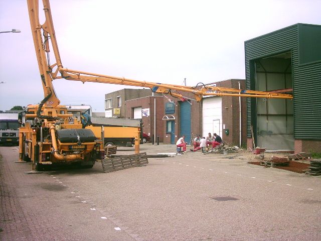

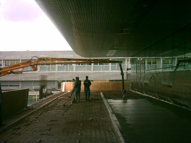

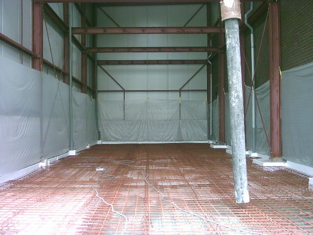

SUPERDOFFER | 09-12-2010 | reply profile send pm notify |
This is one of the things a z boom is made for |

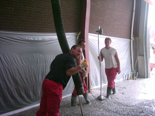

Oh and yes its short rigged but otherwise i can't make enough distands to the door. Keep the custommer satisfied |
PumpKid_88 | 09-12-2010 | reply profile send pm notify |
no sort rig for me but any who what kinda pump is that?... |
Vasa | 09-12-2010 | reply profile send pm notify |
It looks like a Putzmeister m36 Z . Why no shortrigging ? |
pumpjockey | 09-12-2010 | reply profile send pm notify |
You're right, great application for a Z-Boom. It wouldn't have had to be shortrigged to that extreme, the outriggers on the left side could have gone out another foot or 2 (30 - 60 cm), but maybe I can't see what else is going on on that side? Just wondering, why the tall door when there are beams going across to restrict the height anyways? |
Dipstick | 09-12-2010 | reply profile send pm notify |
Looks good supperd! The men in red must have been happy with you again. You guys started with single ended hoses now? Or is it a special short hose for these kind of jobs? But I see your 1st section tips quite far backwards. I have a JMBH 38z boom but my 1st section doesnt tip back more than 1 degree i think. Thats the problem. Stupid spannish... But its an OK pump though. Looking at the price. We have 4 of them but they never seriously let us down. Only small details that are a bit irritating but can be fixed. A lot of parts come from PM. Say hello to ted and the boys next time!! |
Whell pumpjockey shortrigging is shortrigging it means you can't turn your boom that way. So it don't mater how far you put them out unles its ful extended but then its not shortrigging!!! |
Oh and dipstick this is my special 3 meter hose for those special poors. the boys where ready to lay out the system when I sad stop whe can do it of the boom! you can???? yes I can!!!! you have to do some thing special if you have to compete whit the white booms. They love me..... |
That is true, but the wider the stance you can give, the more stable the set-up will be, especially when that first section is past vertical as it is. My pump doesn't do that, so it's merely an assumption on my part that there would be a bit of wobbliness.
Anyways, I don't see a problem with short-rigging on that particular job, as you are highly unlikely to swing past the right front outrigger, or the left rear.
Good pictures. |

hey superd why wouldn't you just go over the beams? why the short rig? looks good until you smack the main cylinder with that knuckle. and it will hit. don't see why you stuck it in like that. that was a bouncin' s.o.b when you was pumping. |
pumpjockey | 09-13-2010 | reply profile send pm notify |
I doubt it was bouncing too bad. No point in having the volume set at 80% on short swings like that.
Not enough room for the manpower to deal with high production rates. 30 m/hr on the volume would be PLENTY!!
And why go over the beam? Much less room for maneauvering.
Or were you being sarcastic? if so, a smiley helps convey that meaning. ;-) |
I've got a 2 meter hose for the tight jobs. |
