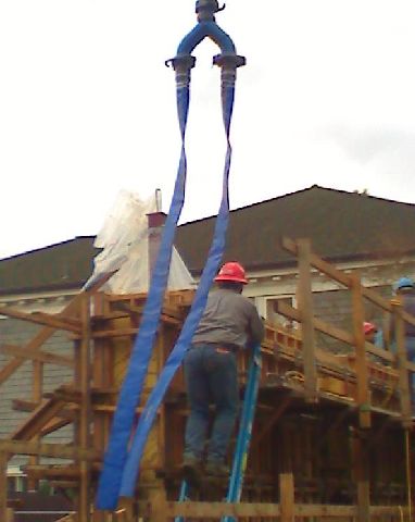

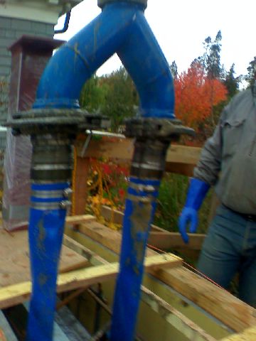

A customer had walls with 4" foam in the center of a 12" wall. As well as sheet metal heating ducts every few feet that were filled with pea gravel so the didn't collapse under the weight of the concrete. The gravel was drained from the ducts after they were striped. They asked if there was any way to pump the walls from both sides of the inserts so they wouldn't move side to side. Soooo, The blue 'siamese' Mud Snake was the result... |

And it worked like a charm! Or should I say Like a Snake charm! Although I wished I'd remembered to grab some extra pins. Had to use the ole ghetto pins (nails) Oh well? |

Next time take your picture showing what it is clamped to. Out of focus or not, I personnally would like to see what that siamese is clamped to. The way the picture is taken makes one wonder if that may just be attached to a double ender. Just my opinion. Have at it boys, I kow where it goes from here! |

M2c ofcours it's clamped to a double- ender ! But the 2 bluehoses has no metal on the end , so what is the problem ?
The weight , dont think so !
We have run this setup many times when We filled around big waterpipes , 1200 mm in diameter with "light-conrete" . |

Of course it's probobly clamed to a double ender you moron! Sure you could clamp it straight to the reducer but what a bitch to manuver, work smarter not harder. Oh and i suppose the reason you said somthing about the double ender in the first place is because of the steel end and how it may be able to hurt someone??? Am i rite??? Well if you look closer my no cents the WHOLE FLIPPIN BLUE PIECE IS ALL ONE PIECE OF STEEL!!!! The damn bell of the double ender would be least of anyone's worries. Good job TT. My no cents strikes again with his vast knowlege of punding sand. |

don't see how the metal ended hose is a problem in this application... although there probably should be a safety chain attaching the Y-pipe to the boom... yes/no??? Very cool setup, nice to see some innovative ideas like this out there... |

Never tried layflat before , probably never had the balls too!!!!!!! always thought it would pop, how long does it last? Did make enquiries about the mud snake but the price was way out. Hey tootall do you get to charge for 2 hose men???? (nice!!!) |

I've said it before, I'll say it again Don't let the ends of the blue hose get tangled up in anything, or you'll never get them out of the wall! Been there, done that !! And use Band-It clamps! Trying to put those hoses on after it pops off is a nightmare! BT DT |

The hose pictured here people is NOT a "Mudsnake", nor is it made by the manufacturers of the Mudsnake hose. This is somthing that someone made in their garage and looks dangerous. I doubt this contraption has been tested for safety pressures and the end is held together with a couple of hose clamps. I would not let anything like this goofy thing anywhere near my job site. |

I think it's pretty cool and I like it. Good job TooTall. Just curious as to how stiff the mix was and if the concrete segregated very much? |

We use that type of hose when doing block fill works good. Just make sure to keep an eye on the inside of the hose before each use for wear. Also ICF walls. Nice job Too Tall on the twin hose setup. I like your ideas and opinions! |

OH MY doG! This heathin contraption with it's two flailing blue whips of death is not only hanging from a 4 foot wire bound DOUBLE ENDED 3" Hose but it's also equipped with not one but TWO dangerous 'death straps' above and below!!! |

HEY WHO! Long time no see (read). You ole JibRoller, how you been? You probably could have. The self consolidating 70/30 7" slump looked more like grout with the occasional 3/8 pea rock here & there! |

I know a couple pipe clamps will keep my hydraulic hoses on, Im sure they will keep those on. |

TooTall I am siding with you on this one but i would just say it a bit nicer that is all. What if it was connected to the end of the boom? that would be ok right? No hose no whip just the unit and the hose coming off of the boom? what do you think TooTall? |

Yeah that'd be OK coming strait off the reducer Todd, since the blue flat hoses do not have any sort of metal end to whip around and whack someone/something. But as you can see in the second picture the metal 'Y' piece is possitioned just above the top of the wall for the majority of the pour. If it were clamped to the reducer the margin for error is greatly reduced and the slightest movement to the right or left, or even up & down could kink one of the tremme hoses or hit a worker. If it were to come down on someones hand or foot, having it attached to a hose could mean the difference between being broken & bruised vs. crushed & cut off! Having it attached to a hose makes it much easier to manage as it's raised and lowered in & out of the wall and also if it were to plug in the reducer. The simple fact of how much the tip of the boom will rise and drop as the pump is turned on & off is reason enough to use a hose between any type of tremme and the boom. |

Perhaps it's just me but when I saw this I looked at creativity for an unusual problem.I had never really thought about this approach,how many did? Still would like to see pic's of the wall and reasons.TT,ya did good |

Are they able to spin the "t" portion pretty easy? Kind of a cool idea. |

I do understand the concerns but as was said earlier I do believe the safest way with this y is attached to a 5" doubleender, straight to the boom leaves very little room for boom bounce human error , I just do believe he did it the safest way possible and I say good job. |

What if he was to lengthen the blue "mud Snake" hose, then you could do away with the shorty hose all together. If you lengthened the blue hose it would resolve the problem of having the Y right at the top of the wall where it is near all those people and most dangerous and the blue hose would give you the flexibility you need for all those instances you described. Very creative but I feel if those hoses were to get kinked or plugged and released or anything of that nature it could cause a whip and with that shorty hose and the Y right at everybodys level it could get ugly. Personally I would have lengthened the blue hose a few feet and came straight off the reducer that just gives you that many less components that could fail at any given time. Still a very clever solution for this job TT! |

its a y if you kink one wouldnt it just relieve to the other port,? just asking probably could be disected and a few things added to appease everyone ,but overall I think it was done pretty safe. |

Yes you are right, but isnt there always that chance that they could both kink at the same time? You know the nature of pumping concrete and crazy shit sure can happen. I always try to use the least amount of components as possible as it reduces clamps, slings, etc. |

And TT, Thanks for showing the total setup. If anyone paid attention to my original post, this was my issue. You all preach safety, I happened to question this particular setup, and once again as in my initial post you all did what I said in the post you would do.Not care what someone else thought. (Have at it Boys) This practice is not safe, and when you provide us with an Insurance carrier that will insure your practice, let me know. Until then, reducer, whip hose, and if you continue such endeavors in the future, don't post it for all to see! |

Sorry TT, I really do not want to be a thorn, but how do you turn a 3 inch into 4 inch and hang it above someone's head? I am far from a dumb ass unless you call me so, (YOUR OPINION), just do not post another comment about safety unless you have a manufacturer or insurance Company that backs you as I previously said. If you do, I WILL STAND DOWN AND EAT CROW!!!!!!!!!! NOUGH SAID |

Sorry 2Cents, Maybe I got the " & ' mixed up? It's a 4'(foot) x 3"(inch) double end hose. I used the shorter hose to keep the wieght down. |
