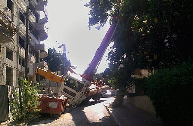

our operator take the boom too much to the side of the close leg. and this haapent. when the big crane came to bring beck the pump- the piston of the leg got broke. nobody injured- thanks god! |

Holy crap Batman I need to go clean my glasses...is that 0 outriggers on the offside??? |

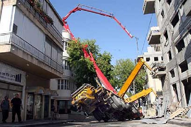

that operator should be jailed to pull a stunt like that.looking at second pic doesnt seem any reason why he is short rigged |

The picture looks as though all efforts were made to keep some of the road clear for traffic to pass. In an effort to make a GC happy, possibly saving him the $$ of a permit to close the street, the pump company made a decision to set up a machine that ultimately will put human error to test. So what happened? The road had be closed afterall. I would suggest using these pictures as an example for GC's that don't think it's cost effective to close a street down to safely set up pumps/cranes etc...with their outriggers deployed. I realize sometimes short rigging is unavoidable. When this happens, it really is kinda simple: Keep the big boom thingy in between two fully deployed outriggers... |

thats still a tite corner to get by maybe a smart car could get by there but still sucks it had to happen but yea dont see any reason y he couldnt of put drivers side outriggers out but im only a lp guy so what do i know |

taking a second look at the first pic also looksl ike he was pretty close to the power line also least it looks like a power line but we all have our mistakes |

By the looks of it that tree kept alot of extra damage from happening. Nobody was hurt and that is the main thing, where he goes from here is the next thing. |

Is the right front extended all the way ? sure don't look like it. this was a bonehead setup. |

This is a prime example of the wrong machine on this job. Looks to me like a 28 meter could have done the same job with a much smaller footprint. Maybe an experienced operator would have seen this, or just no management! |
