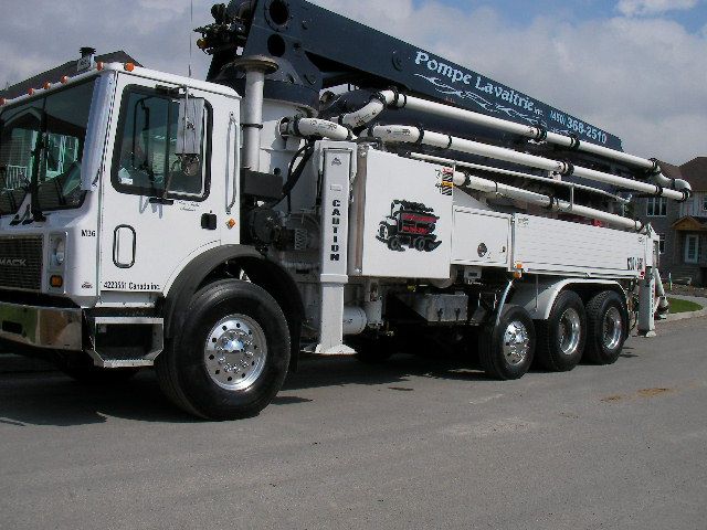

I got 1997 36m schwing with a accumulator.I heard that when the bag or the balloon blow up your done.So i need some help .I ask my gaz guy and he has no problem filling my accumulator with nitrogene but i ask him were can i find the bag or the balloon ?He says that belong to schwing to sell me it.I call schwing in montreal and he says that it s the gaz guy who has that. I don t want to be stuck on job but am i too cautious.Do we have sign before it blow up.Do you work with your hours meter or you just wait to blow you need to have it in spair. |

almost forgot nice looking rig you got there. |
