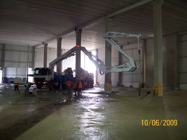

Adjusting Boom Speed
52putz 09-03-2010
Not familiar with the brand but on a Putz you can adjust the valve reaction for initial stick movement and full stick movement.  Then, the proprtional band is figured by the computer to evenly move the valve within that range.
Can you set the initial stick movement?

Sounds like a bolt on the stack valves?  Can you post some pics?

well... The norwegian name would help a lot too ;-)!! Ill have a chat with our mecanic about it. Thanks! But what could be wrong then? Because all cylinders have the same problem kind of. swing, and all the sections.
Pump N00b 09-04-2010
As you said in the first post, that the levers moves as soon as you move the stick on the remote, but the cylinders on the boom doesn't.
This makes me think that the pilot pressure is set a bit too high, so you have to build up a lot of pressure before they opens and the cylinders get fluid and start moving.
A setup like this is good for black-white remotes, not so good with proportional remotes.
If you adjust the preset pilot pressure down a bit they wil open sooner and flow oil to the cylinders.

Pump nOOb...Nice way of explaining!!   This realy sounds to me like this is the problem yes. Might also explain why the reaction is so agressive once it does start moving..
But you said someone from cifa had to do it for you? could not do it your self??

Good Good.. But just one more question... How to do it??
Kris Leers 09-05-2010
I got a mail from Dipstick and explained him how to adjust it.
It is indeed like 52PUTZ says the adjustment of the radio controll.
Just like Putz the JMBH has got a HBC radiocontroll. You can adjust the valve reaction for initial stick movement and full stick movement.

Only I have the 4 section 38 Z. But could it be that Pumpnoob has a good point?
