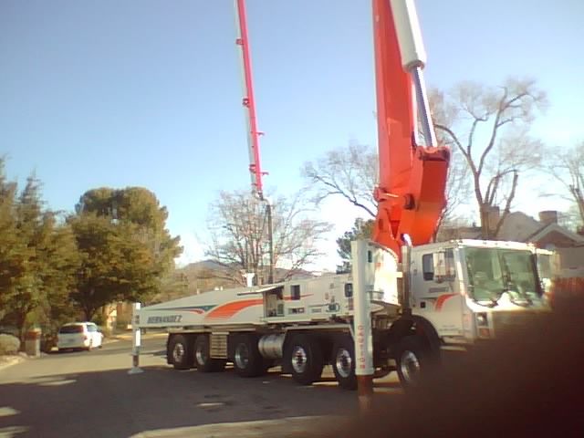

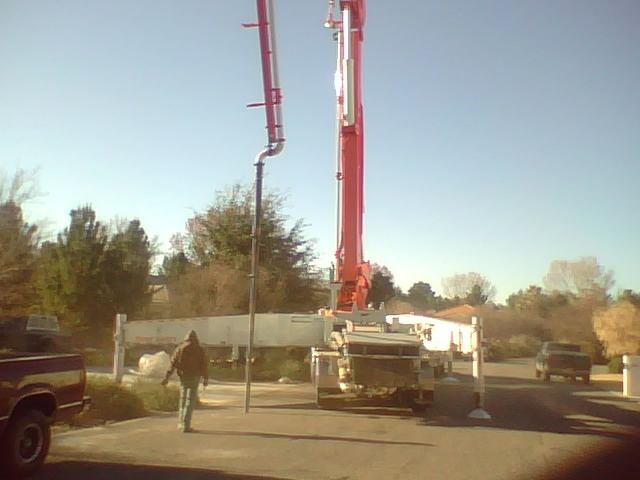

this was a residential job, where there wasn't any space for a big pump. i had to find a way to set up the pump and leave space for a one way vehicle passage. |

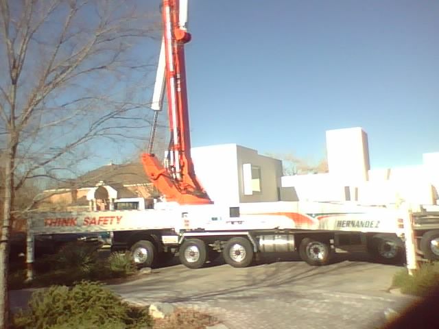

i had to set up the outriggers on the land scape, and short outriggers on the other side for traffic. |

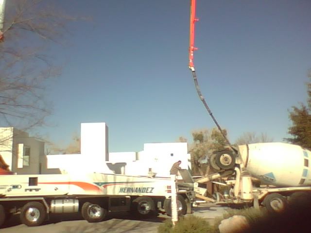

i had to prime the pump in the mixer. in the end i had to water wash the pump in the mixer. |

Water wash is my normal MO. I've primed into a mixer, but it's a nail biter. |

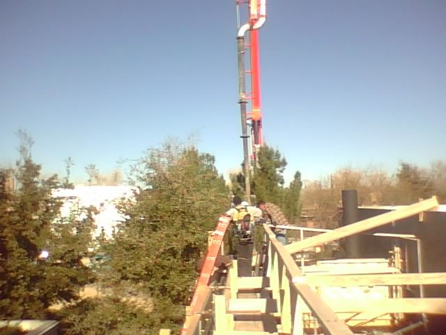

pretty cool, but I got to point a few thing out here just for fun. 1st, on your outrigger it says "think safety" , then I see your not only short rigged(understandable) but you also failed to use the donnage or cribbage under the out rigger feet (there visable still in the racks ) and you have your pumping side in presumably soft landscape ???????? LOL 2nd, damn what a long tremmie hose you are using,Im assuming that is standard procedure ?? But wanna check that nice little safety sticker on your 4th section that says maximum weight #225(Im going off memory but thats close). But heck you did not bring your scale with you so lets assume it was under weight today . LOL Im just yankin your chain , I love operators with a sense of humor and this job looked like you needed some humor to finish it. Thanks for sharing your pictures with us and Im glad to see you guys at Hernandez getting some work .

Not trying to start sht, but the pictures don't show the reach needed except in the one you could see it looked like the tip was straight down. Maybe a smaller machine would have solved all the issues, with the exception of prime or wash. Jobs like this we usually wash in a kids swimming pool under the hopper and they would cart them off later. Never had a problem with that route. |

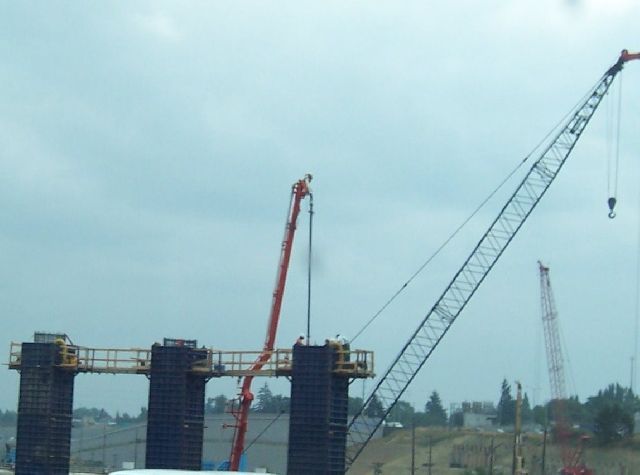

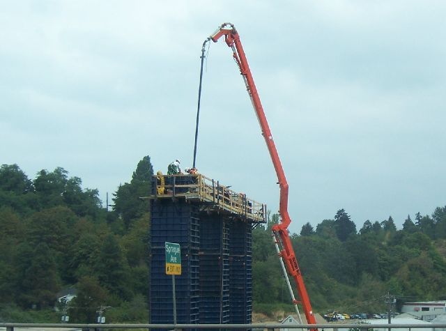

If I remember right Too Tall awhile back posted a few picks in the Northwest whers they took the fourth section off and made an adapter for the hose. |

thanks for the picture , it kinda looks like a 39meter to me but im not sure. It just seems like alot of trouble to do that ? But it also looks like they put alot of thought into that job ? |
| Boom Inspector | 01-23-2010 | reply profile send pm notify |
It also looks to be a safe alternative too and judging from what i can see they are using proper safety cable to each hose connection and with the tip removed the weight issue would be no problem . |

Definitely not a 39, it is at least a 45 or bigger. My guess is a 47 |

the land scape for sure is wet and soft thats why i used all my outrigger pads as some four by fours to support all the weight of the boom. i also used a 5" by 4' hose, a reducer and a 4" by 8' pipe, not a lot of weight for the tip section. i was using all safety measures on the side where i was working even more using 4 by 4 pices of wood under the outrigger. |
yea sergio, I was just bustin ur ballz is all. Its not clear about the donnage on the drivers side at first glance, but now I see what you are talking about.Sounded like you got the job done and all went well even though it was a pain for you . |

hey boom inspector i had alot to do with that 47m that is a great way to pump caisons and those colums you see average pour where between 300 and 400 yds depending on the size of the colums.do crain to help out we still have a ton to go.,. |
| Boom Inspector | 01-24-2010 | reply profile send pm notify |
hey bigpumpb , so it was a 47 not a 39 . At first glance I was'nt to sure. Do you know the history of how that idea came to be with that boom set up ? |

Curious on the priming, could you not just prime in the hopper?Or was the issue, not being able to kink hose. |

It's schwing 47m, and it works great! That contraption is such a life saver for casions and columns ect. |
| TooTall | 01-24-2010 | reply profile send pm notify |
Hard to believe those were driveby pix taken from the freeway! |

I like using a short hose above a tremme so I can use my aircuff. It's also not as rigid and a bit easier to move around for the nozzle man. |

hey Rookie, to prime in the hopper it is easy but the thing is that in this town, pumping at 6"slump is considered wet concrete, so most contractors pump concrete as 5" max, if I prime in the hopper, I am going to make more than 1/2 a yard of wet concrete and there wouldn't be any place to dump it. on the other hand you can start priming at 3" or 4" slump in the mixer. You're going to increase the slump of 10 yards to around 5" slump. |
