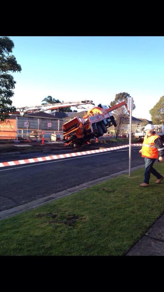

28m kcp tipped in Melb this morning |

Wonder if this was operator error or a machine failure ? |

that model pump old 28 meter back out riggers come down on a angle they dont extend .looks like he set up on soft ground ' |

I don't know if it were soft ground you'd think the drivers front wheel would also be on the ground as the out rigger sank. It looks like he was using all 4 outriggers as the rear don't swing out on that pump. Maybe he tried lifting something |
