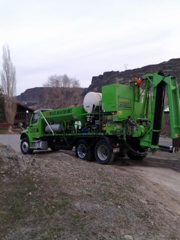

Didnt work too well....... |

We don t know why,but everytime we have to work with it,the ratio m³/hour is very low .Good for us !! |

What make of Volumtric Mixer is that? It looks rather home made? Do you have a larger picture? Or others? |

Everyone should experience those at least once in there life |
| Beast | 04-09-2013 | reply profile send pm notify |
they do not work very well with pumps in my experiences, but I'm sure they have certain places where they are perfect for the job at hand |
| Travelteck | 04-09-2013 | reply profile send pm notify |
I was with a customer that had both volumetric mixers and pumps and they were working well together, I wonder if the settings are in need of tweaking.
| thommyman | 04-09-2013 | reply profile send pm notify |
Its the only pic i took. The guy was an hour late and made a huge mess everywhere.Not something i would reccomend. |
| pumpjockey | 04-09-2013 | reply profile send pm notify |
VM's are tricky beasts. The materials loaded in the hopper must be very consistant throughout. Whereas a regular 'batch-mixed' truck has a large volume of material that is 'averaged' and mixed virtually homogeneously. A VM is continually mixing, and only has 6 to 10 seconds in the auger to mix, and the cement has had virtually no time to absorb the mix water, also the admixes have also had very little time. A VM is all about the operator - he's the 'batch man'. |
| Pumperman430 | 04-09-2013 | reply profile send pm notify |
well to add my 2 cent to this , we work with an all vm company near us ,mixing is sometimes a small problem, but with only running 40 yd an hr trailer pumps they dont do bad keeping up with us. I'm sure keeping up with you guys with the boom trucks is a different story. |
| putzman1975 | 04-09-2013 | reply profile send pm notify |
not enought mixing time .seperates easy hard to pump. |
| 3/8Pumper | 04-10-2013 | reply profile send pm notify |
No my boss has when in the line about 50 feet and plugged and now we dont pump any Mobile mix |
| murf | 04-13-2013 | reply profile send pm notify |
We got loads of these over here, thay aint bad providing the company buys good materials, trouble is a lot of them are run by small outfits who buy the cheapest materials they can. Always stick the first two barrow fulls straight on the deck, not in the pump or get the driver to run the sand down the belt first with no stone. Be carefull of them running out of material as they dont no till its too late and you got a pump full of crap! Schwing 900 on tick over is just nice for them speed wise. |
| Vitulla | 04-13-2013 | reply profile send pm notify |
One of our clients has 2 of these fresh batch trucks that calls us several times a month. It's usually very few meters and the pours are slow, but it works well. Speaking from a line pump perspective though. |
