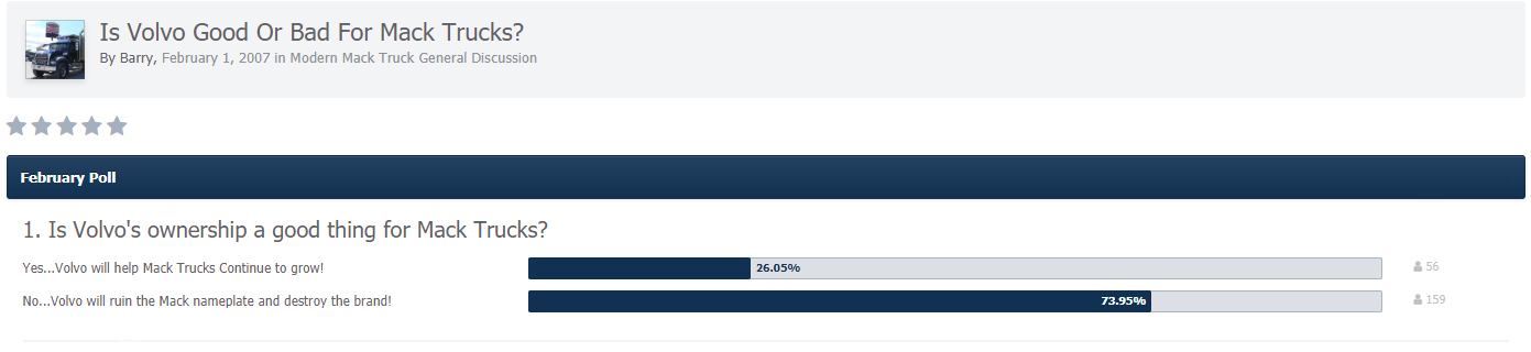

The frustration level of Mach Truck users is growing all the time. I really believe the customers have to just switch and quite buying Concrete Pumps with Mach Trucks. This survey was taken back in 2007 when people were asking will Volvo's ownership of Mack make them a better company or a worse company. Looks like the guys who thought it would make it a worse company were right. |
