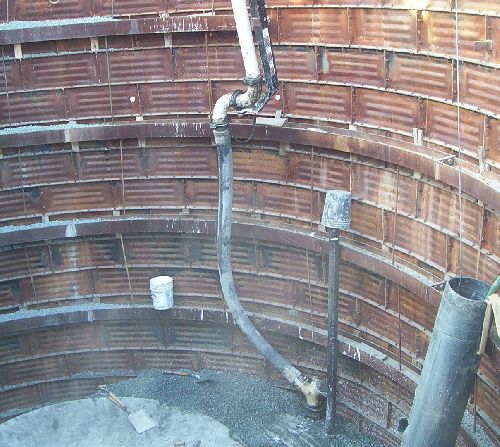

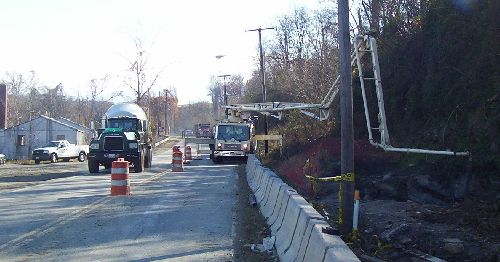

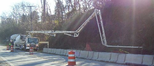

Encasing tunnel lineing and sewer pipe |

great pics,how'd you ever do that without me? pour it out |

very cool. |

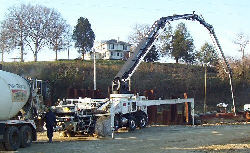

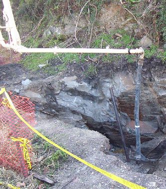

Can I ask a stupied question?What are you plug into?Are you filling a pipe or something.And are you 17 feet away from them power lines.LOL Ruck |
PourItOut | 11-28-2008 | reply profile send pm notify |
Yes Ruck 20 ft below lines,,,, The tunnel Lineing is 11ft dia with a 8ft dia concrete pipe inside, 740ft long,, took 678 yds to fill it. grout |
Filled the space inbetween the tunnel and the concrete pipe |
