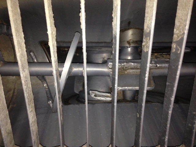

My agitator shaft is bent or warped and it is causing the hydraulic motor to leak again. I don't know what causes this or how to straighten it? Any ideas? thanks. Its a 02 Schwing 32 M style hopper. |

Is that shaft hollow? Today while pumping i was looking at it and there is an area where the mud drops on it and it is thinner . Still two inches plus, but must be hollow to be bent. i might take it out straighten and build it up with metal strips. |

Good to know. im thinking of pounding it straight then welding some reinforcement strips on the sides. its really just in one spot. Now i wonder if just a seal kit will fix the new hydro motor? its only a few months old.

It has a bend just to the left of center, i might try heating it and bending it with something. |
