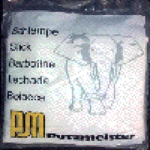

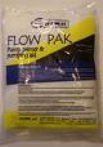

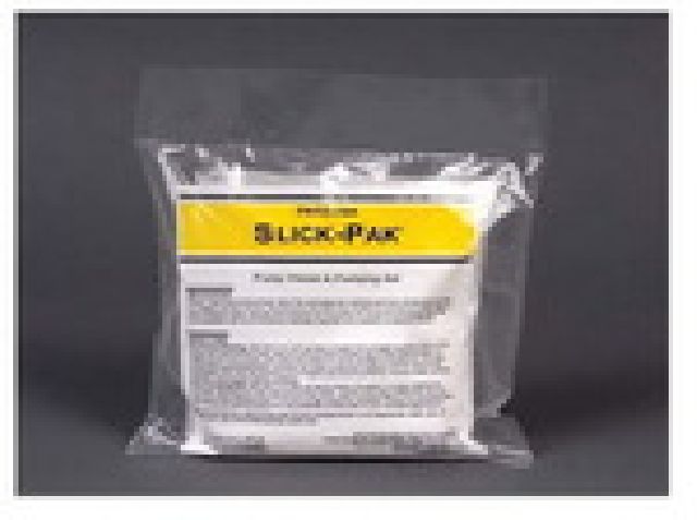

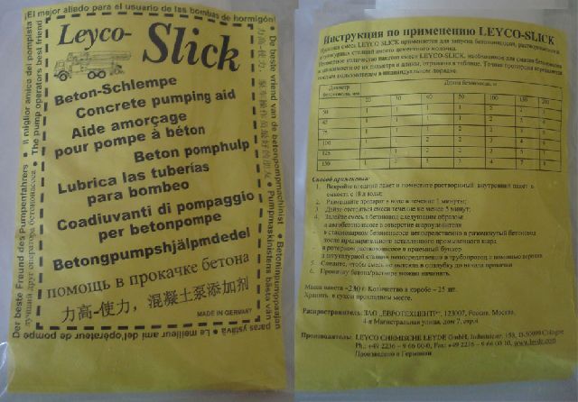

mhat is better? Leyo slick Flow pak Slik pak Fritz pak putzmeister |

Schwing, putz, and Conforms make the best ing my option. But it all looked like the same powder. I've never used liquid prime |

Yeah, we had it a while back, I don't know if the are still making it. It look like the same stuff as the putzmeister prime. I like the fine powder, not the bigger beads. |

The liquid prime sounds cool though. Our placers would rather water prime, which most all machines do in our area, and prime slow then dump water in an area then back to hopper and mix the rest without over slumping that first meter of mud. Then if line we might add bagged powder as slurry to line, just because it does not have a chance to contaminate the mud. Might sound old school but they are super fussy in our high end district. Thoughts welcome. For additives if it's a must we use slick pack.

Never had an issue with Slick-Pak II works like a dream every time |
