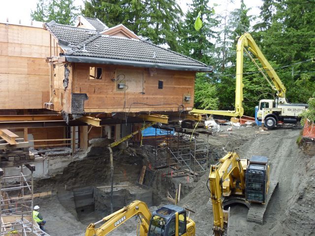

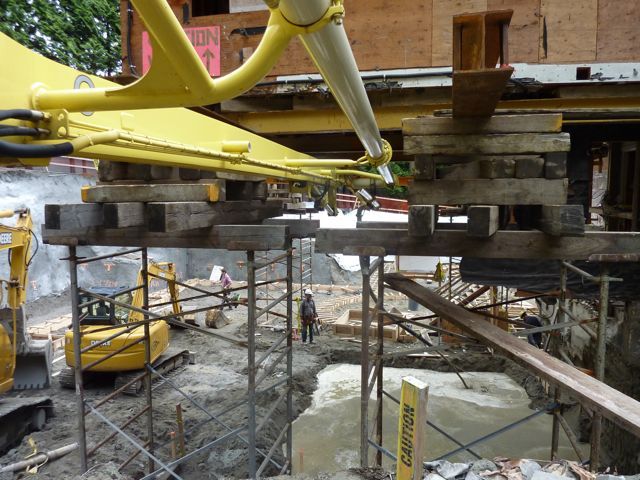

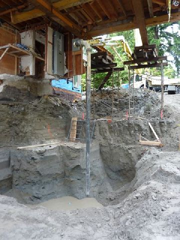

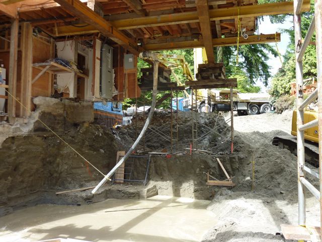

80 cubic meters of density fill pumped in place of removed oil tank, another one of those jobs where a slewing tip section would come in real handy! |

With my very limited amount of knowledge of physics,I wouldn't have put my tip in there at all. Looks can be deceiving, but there's nothing but scaffolding holding that part of the building up!. I see dead people... IMHO |

I have never seen a house held up with pipe staging? I may have left! |

job well done. |

I have been talking to a scaffolding builder today 4 pipe system can hold 12 metric ton's, I see 4 time's 4 make's 48 metric ton's. I think they are far on the safe side if you don't have seen it before don't mean it can't be done. |
