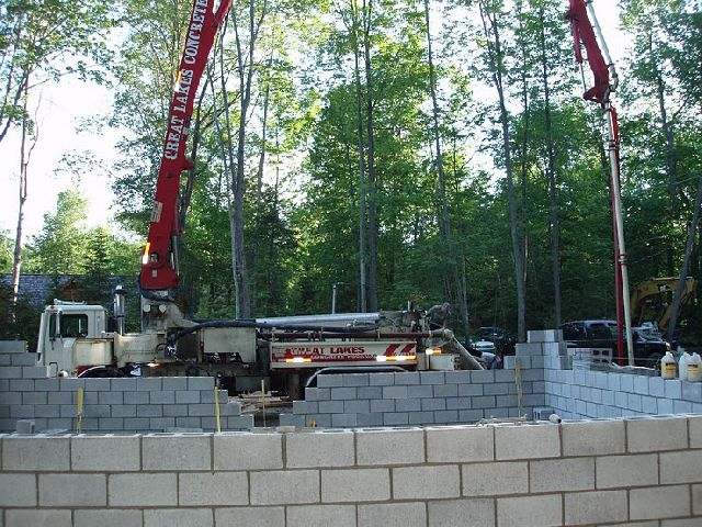

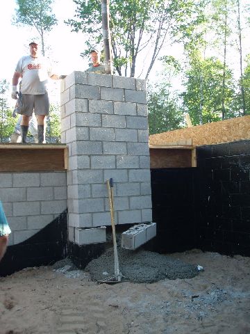

says alot about the block layers doesn't it? |
| 52putz | 09-24-2010 | reply profile send pm notify |
Sluggin a bit early...the mortar is still REALLY green...like the guy who ordered the pump. |
| bisley57 | 09-24-2010 | reply profile send pm notify |
line pump would generate less pressure on the blocks......wheres the rebar |
| jbrown | 09-25-2010 | reply profile send pm notify |
why would you boom that? |
| 79xlch | 09-26-2010 | reply profile send pm notify |
Looks to me the block was a form, not the cells being pumped. Concrete was dropped from the top and being wet there was a lot of force. Even a fully cured mortar has limitations. |
