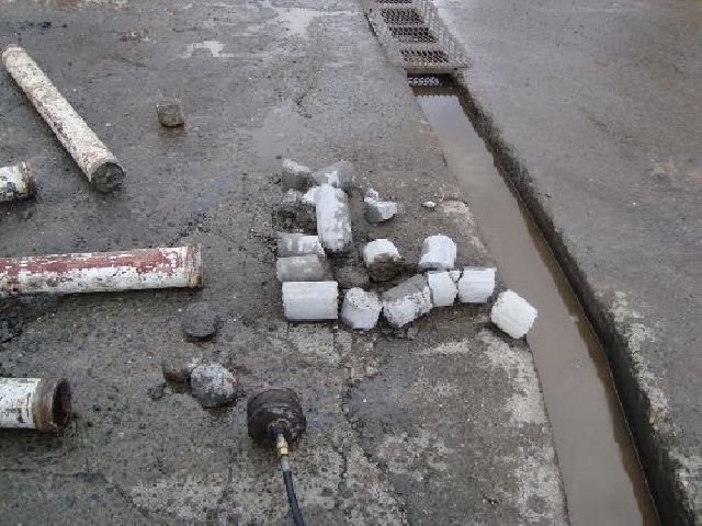

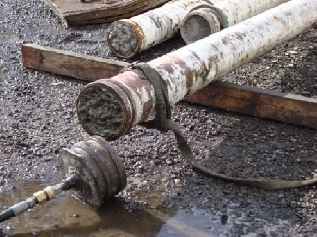

Besides the violence and danger involved. There's alot smaller window when trying to save pipe with air pressure. The right pressure washer can blow out a piece of pipe (fence post) that's been laying behind the shop since the day of the party. Whether it was last week or last summer! |

It's sometimes even powerful enough to push the interior sleeve out on dual wall pipe! |
crete | 04-04-2010 | reply profile send pm notify |
Is that hose pressure hose at the bottom center? Will a home depot cheapy work with 2300psi and 2 or 3 gal/min.? |
pumpjockey | 04-04-2010 | reply profile send pm notify |
You bet, the Home Depot cheapie will work! |
