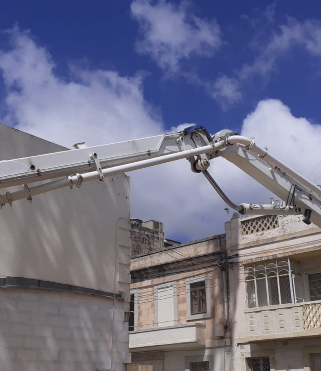

Ready mix company was operating a 36m boom pump, correct stabilised and normal operating conditions. suddenly one of the boom cylinders buckled (bent) and the whole boom came crashing down leaving a fatality. I am not a lawyer but a dealer selling pumps and would like to see whether anyone had such an experience so we all learn from it and avoid similar cases. I am just trying to help all other users out there. |
| rainman66 | 07-14-2020 | reply profile send pm notify | ||
here is a photo to help you understand the failure. |
| TooTall | 08-04-2020 | reply profile send pm notify | ||
That hydraulic cylinder is too small. Compared to other 36m booms, the hydraulic cylinders that control the 3rd section are considerably larger. Larger cylinder, larger chrome rod, larger pins & pin boss's. The levers are noticeably smaller as well. Poor structural design. |

It was the second section, just for record purposes, but very good point indeed. i would like to compile some info on typical diameters on most major pumps. can anyone share some diameters for chrome shafts on the cylinder that opens the second boom on a 4 element 36m pump please. and pin diameters perhaps too that hold the cylinder to the boom and articulated joint? cheers |
