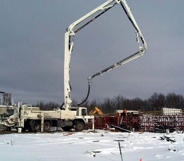

I have to ask how many of you do this....I do it all the time and I am surprised how much water ends up in my priming port after I have done this. I have never had a plug on cold days when I Pre Heat the boom and I go and prime. |

BTW, nice pic 38zman, but that's not a Z or a 38? LOL What is that on your pipe for insulation? |

LOL Yes I know it is not a Z It is old school R&F...lol as for insulation I cant tell you what it is but it works great Yesterday in the cold with the pre heat primed like it was the spring The only problem is it heats the placing hose and if they are bending the end it stays in that shape...lol Last thing the pipe is only as good as the clean up the night before so if you are puting alot of water in the boom with the ball not all of it comes back because it freeze on the inner wall of the pipe and after pre heating you se how much did not come back with the ball... |
