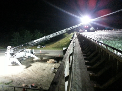

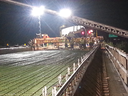

worked with another company today to help them out because they only had one belt and couldnt reach the center of the bridge. had the belt as far vertical as it could go and it worked out great.. it was lightweight that wasn't soaked properly so it kept going from a 5 to 2 inch slump about 1/4 way through. the company I worked with was "all ways concrete pumping" out of New York. really good operator too. hope to work with them again sometime. |

Did you use anything to break the fall of the crete? Some times it will knock the air content down by dropping it to far. T |
| Mister_Perkins | 07-20-2013 | reply profile send pm notify |
had the hose right above rebar |

the belt was about 1 inch away from their hand rails when extended out lol |
| whole9yards | 07-27-2013 | reply profile send pm notify |
Not having any boom bounce sure helps with those tight fits. |
