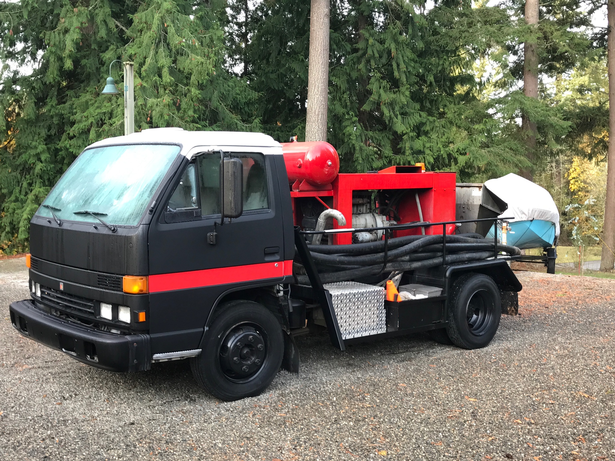

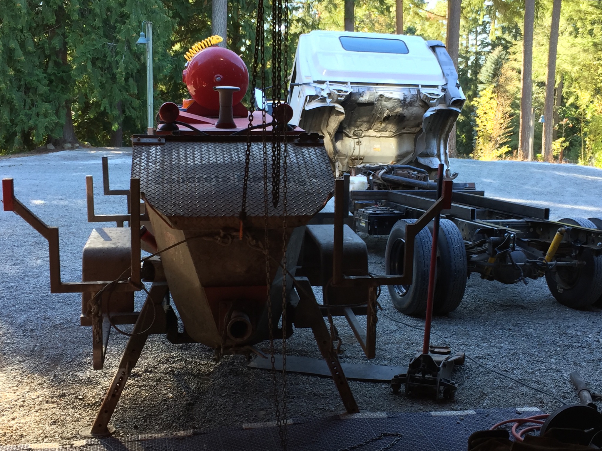

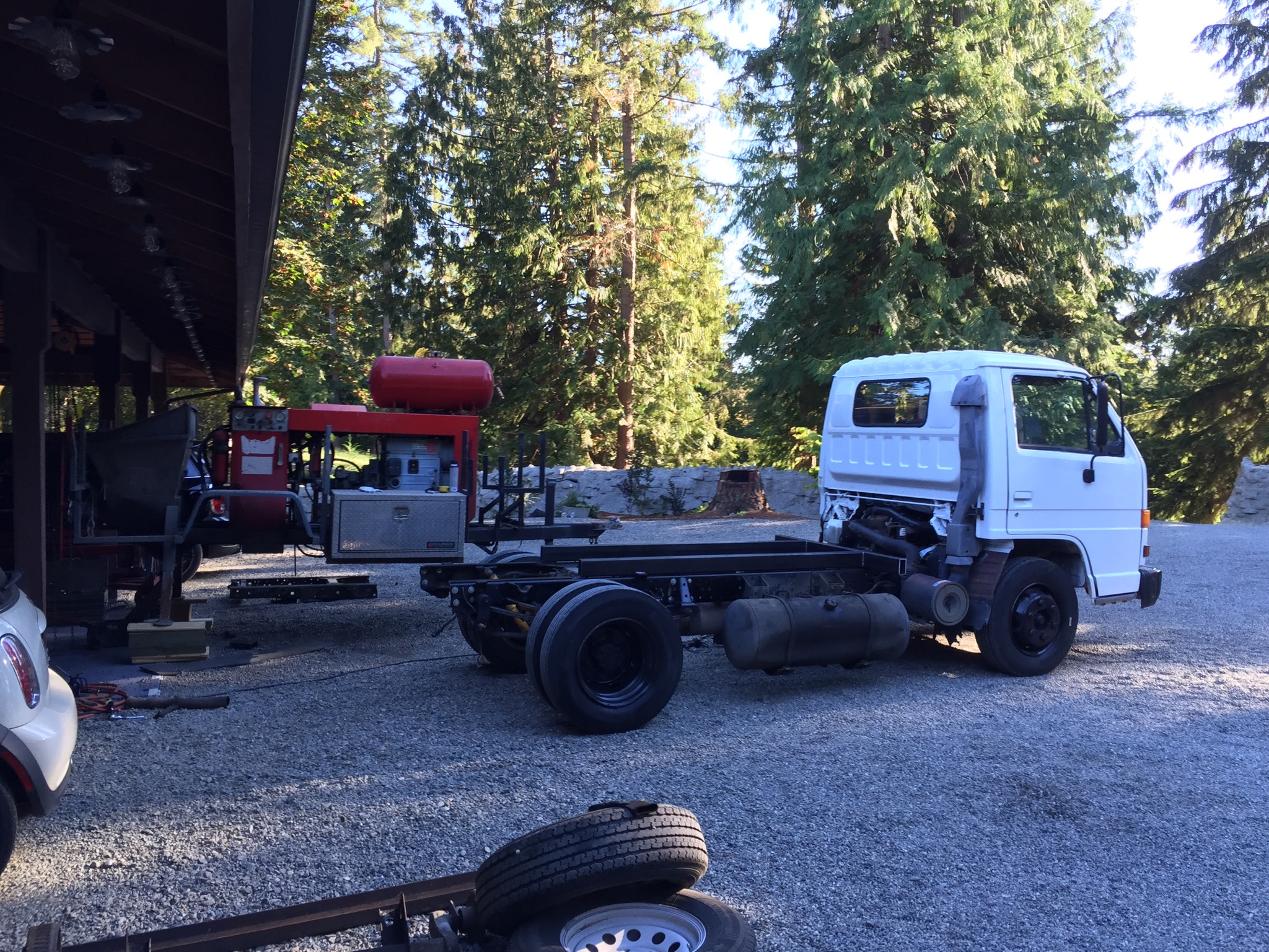

Been awhile since I was here, bought a transcrete trailer pump from a member here a year ago, plan was to build the tiniest mobile pump ever. I cut down a Isuzu NPR that has a 4 banger turbo Diesel with Allison auto and overdrive. Pulled 4' out of the chassis and moved rear end forward as much as possible. Cut off all the trailer junk and added 4" frame tubing underneath to get a bit higher to be able to run hydraulics and hopper at an easy angle for trucks to back up to. So the wheelbase is now 10', fits anywhere, you can Uturn on residential streets, can't feel the weight of the pump even if hoppers full. So easy to set up and break down. I never want to drive any of my big pumps ever again. Never ever never. Oh and fuel consumption is a joke now, I can go all week without filling pump or truck. Paint is almost finished, top gets the black treatment. Oh pump fits in a normal residential garage as well. I might just start building tiny pumps for a living |

Nice work! Looks great |

your hopper is too high off the ground. i have trouble with a volmetric conveyor being tilted too high just for my trailer |

My hopper is to high?!? It's 4' that would mean all my other pumps are wrong, everyone else's too |

Great job! Thanks for sharing the photos. There are a few mechanics left here.. I've considered this option but still pulling a trailer. I like your choice of truck. |

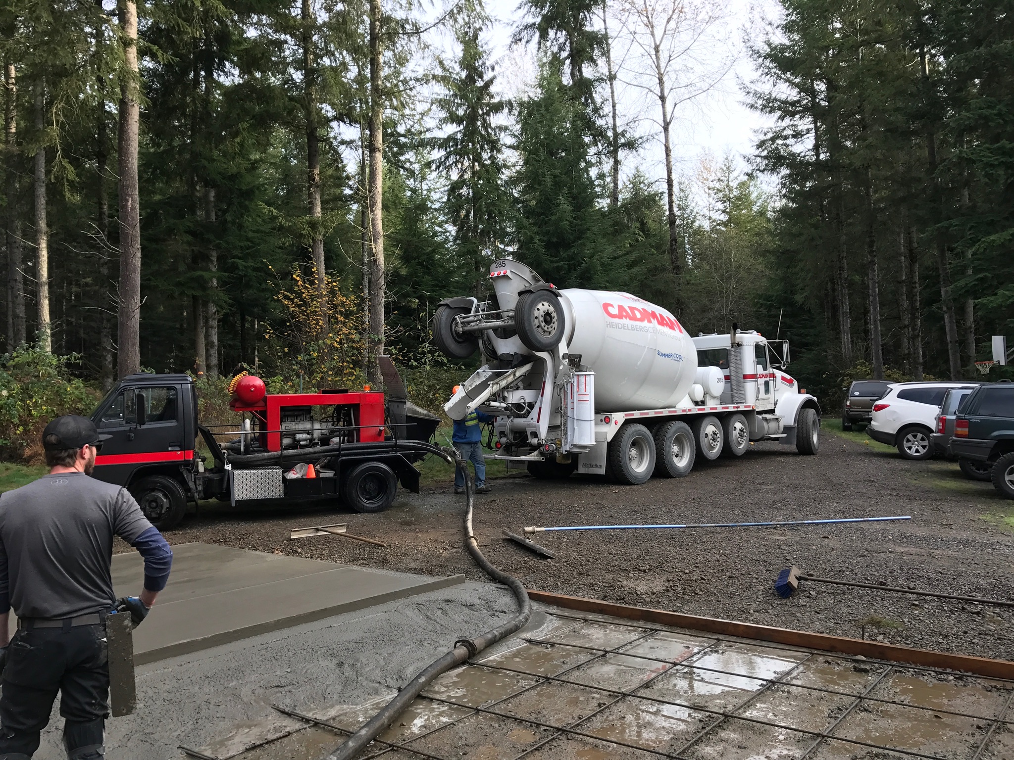

| barron | 11-14-2016 | reply profile send pm notify |
In action |
| orygun | 11-25-2016 | reply profile send pm notify |
think you missed painting the wheels red also |
