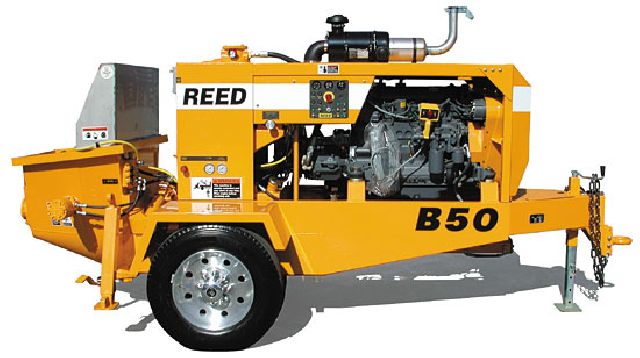

looks like your job size need is a reed b-50 there is a 2006 repo in phoenix arizona for 30K no picture but have a equipment number and a contact that iam not sure to post
REEDPumps 02-16-2010
thanks Eugene - I agree that the B50 is better for what he's doing.
I'm quoting him on a good used demo 2002 B50 we own.

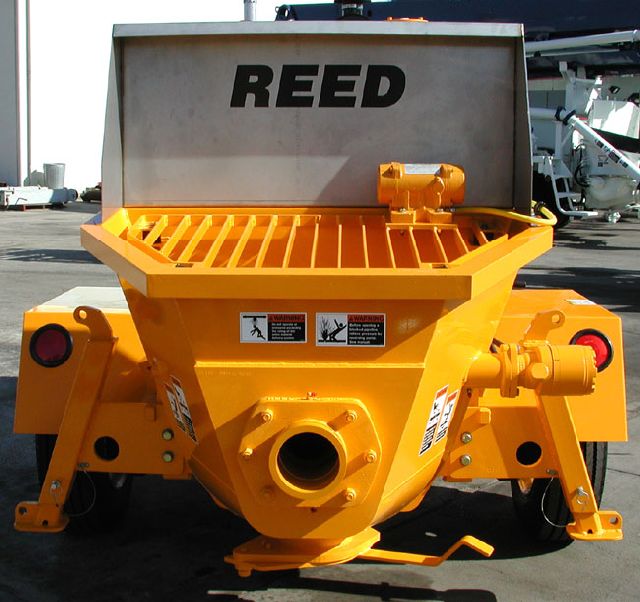

Mike my question for you is why not put your viberator on the under side of your grate with it on the top side its to easy for a careless mixer driver to back his chute into it a damage it, I know being under it will get more concrete build up but it will always work.
hey there Biged - I've never had a customer call me and say a mixer driver busted off their vibrator - but - we really don't sell vibrators on many of our line pumps. Sounds like a good suggestion though -  I'll pass it by our Engineers to see what they think...
One thing we DID start doing about a year or so ago is angling our hopper splash guards so they're less likely to get banged up by mixer chutes - I think this change was from a suggestion we had a while back from one of our Dealers in Florida, Mr. Earl Bouck.
Anyway Biged, thanks very much for the suggestion...
Mike @ REED

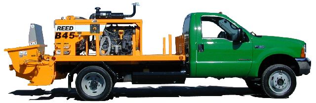

hey mike i did notice that it was common of the back spashes were getting hammered, bet the new dangle will help. so while i have you on here do you know the ford truck model you have with the B-45 on it. my queston is can you slide the pony motor foward to back of the cab. clearing the wash box. i think it would balance the truck better and i load 17 foot hoses horse shoed so i can pull them off eighter side standing at the courner of the bed. thats the set up i would have. the schwing model on a ford 550 will not work, the cab to axle is a foot short. would have to separate a putz trailer unit and make up new hyd hose lengths. all custom and expendsive trail and error.

OK Eugene - about REED Truck-Mounted Line Pumps - that's a lot to cover here. But that image you are talking about is a B Series line pump on a Ford F450 (see the photo of that machine above).
Yes, it is possible to move the motor toward the front of the cab (customers have sent me photos of what they've done themselves...some are pretty, some are kind of sketchy).
We would be able to mount the REED Line Pump however you want it done...but to hire us to do it isn't cheap. Instead of being done on the production line with the rest of the REED Line Pumps, it would be taken to a special area where our engineers and welders and painters would create your dream pump - and everything would be done right. If you want pricing, please call me and we can work you up a quote for your dream pump...but, as I said - it will be expensive compared to just buying a trailer pump.
My personal thoughts on Truck Mounted Line Pumps is that in theory they are a good idea, but in practice...they're really not worth the extra expense/hassle. Here's why - the pump will outlive your truck...so you'd have to re-mount it when you get a new truck, which is a pain. Also, if your truck is in the shop - so is your pump...and vice versa. And what about on the weekends when you want to take your truck to a nice restaurant...do you really want do pull up in a T Series pump? It has its place in areas where there is no extra space at all - like New York City...I guess the extra pain of having to maneauver a trailer in such tight areas makes it worth having a T Series Pump but ONLY in New York or other areas like that (see what we did for our New York Dealer, Almeida, and his REED B70 Line Pump - this is a great little tight city package)...
