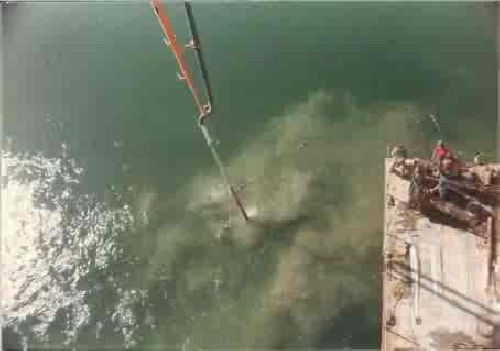

I have never worked with this before. An add mixture called "caltite" (amonia) supposed to make concrete/grout non-pourous or "water-proof" I am using this stuff for pile repair (under water) and it makes the water "shimery" like diving in gasoline. How long has this been used or is it new?? |

The guys top-side are complaining about it. It dont bother me none, Im the one underwater. Its all a big gray cloud to me. |
