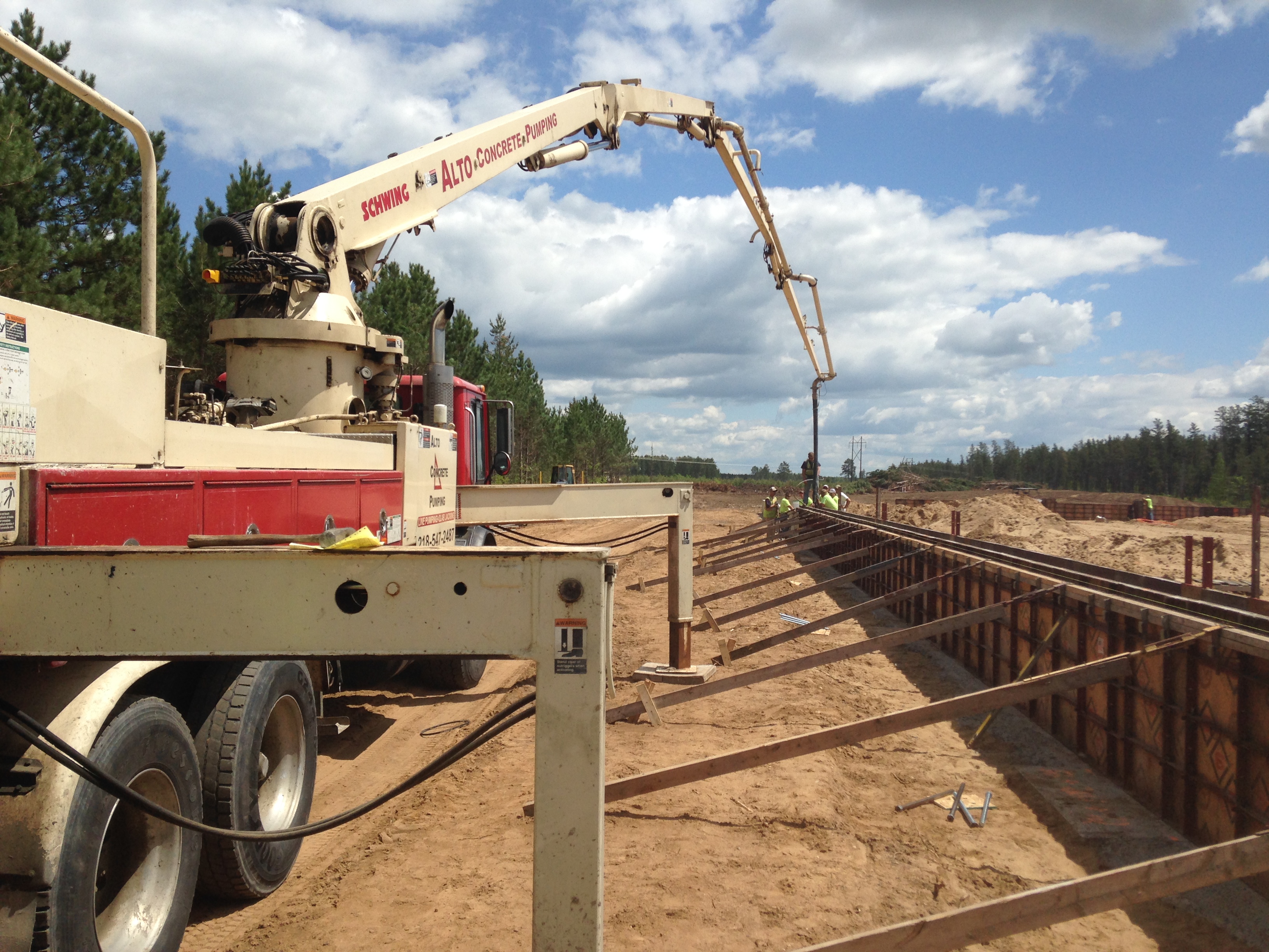

Dang my photo worked! That was just a test i haven't been able to post a photo I'm months! |
